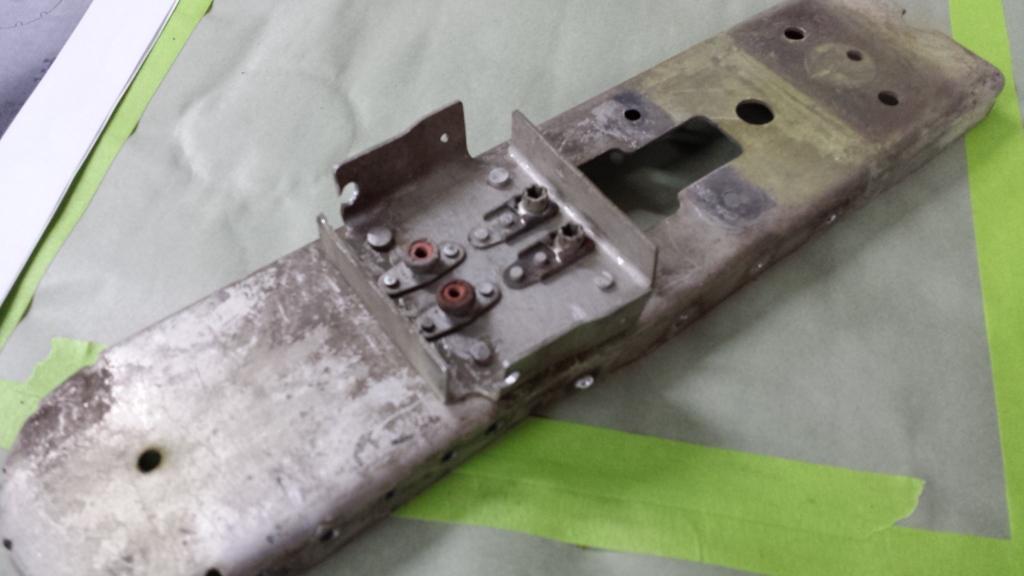

While I am deep into a restoration of my 140 I would like to add the doubler to the rear fuselage bulkhead to eliminate the recurring AD 47-52-02.
Univair wants and insane amount for one.
Does anyone have a pattern I could use to fabricate one?

This is the Tailpost with the doubler in question.
Tailpost bulkhead.jpg (61.83 KiB) Viewed 4380 times

Not the best quality but all I've got...
Re: Fuselage rear Bulkhead doubler
Posted: Thu Oct 01, 2020 7:17 pm
by 8342
That helps.
I can make it with that.
Thanks,
