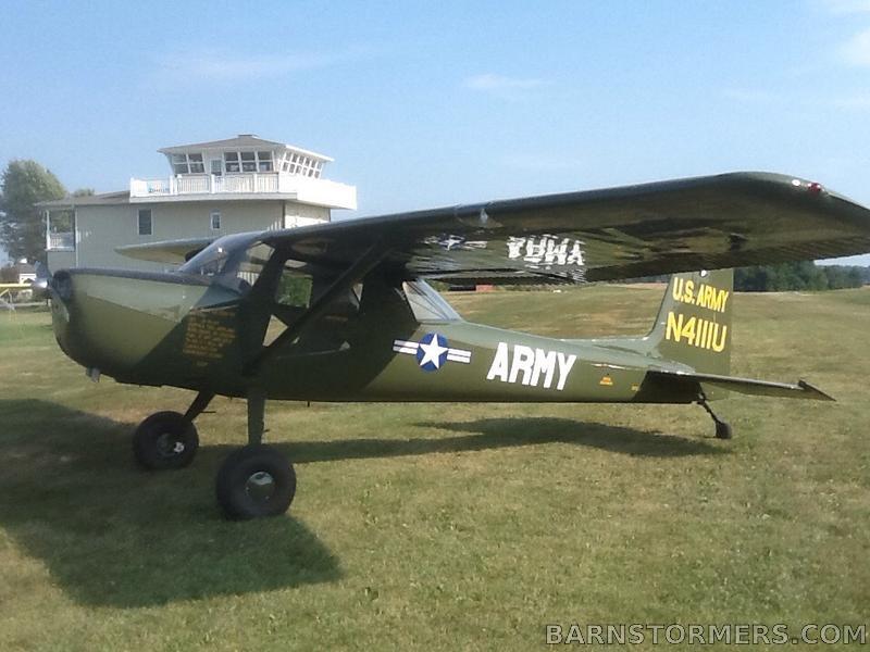

...maybe best to find (...build/convert?) a David Lowe 150 taildragger? The best of both...a great trainer with 150 seats already installed (A "$2,000 bonus" right off the top of the acquisition cost ;) ). Mac

If the right 150 came along I’d certainly consider it.
