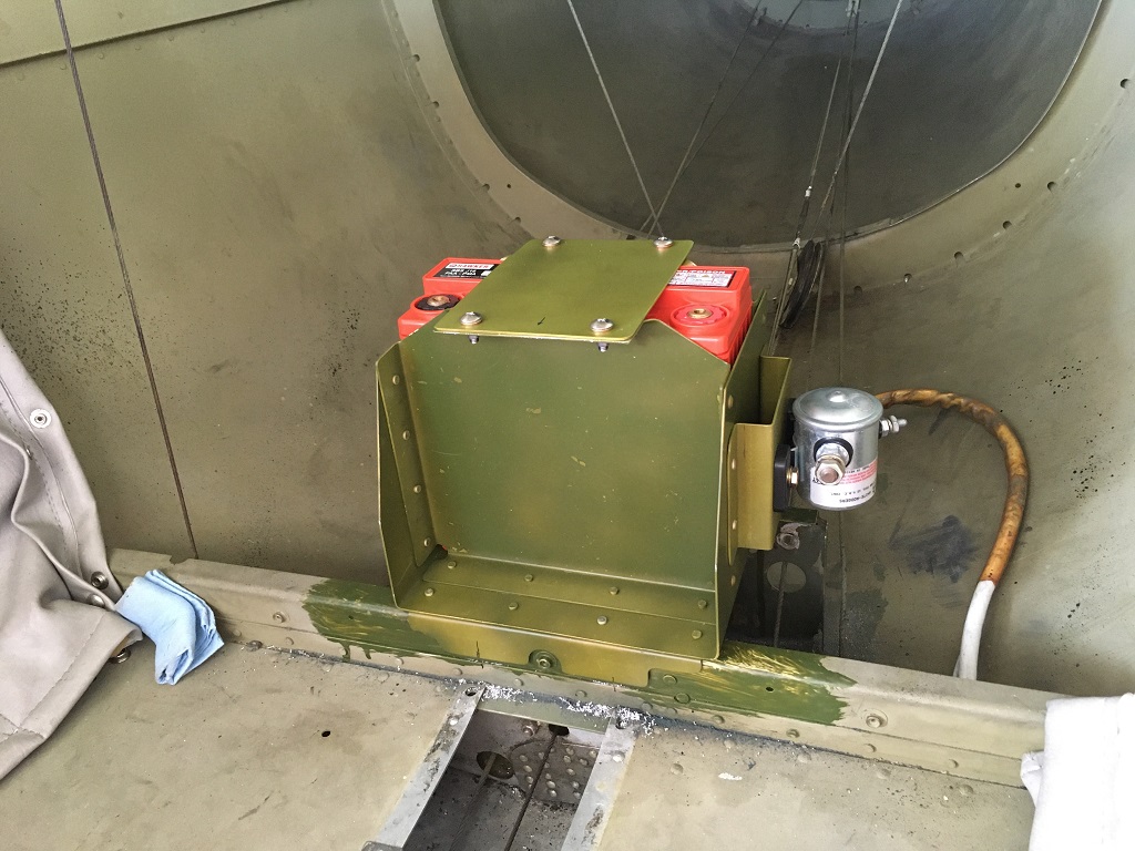

I just completed the fabrication of a new battery box to hold the SBS-J16 battery.

Nice lightweight battery and good looking work Dave. I see for now field approval is required. I would hope we'll see an STC in due time.

All the debate around the necessity of a 337 and/or field approval had me a bit worried about whether I could legally do this modification. My mechanic/IA said not to worry, he'll just make a logbook entry. Good enough for me.
