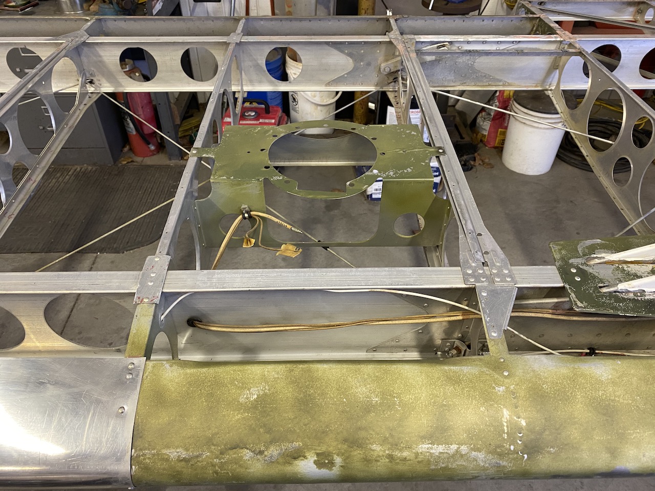

Question: Since the Grimes motor, G2905, seems to be standard across a variety of Cessna types, as well as the bulb, is there any cross over of Grimes lights from another Cessna type to a Cessna 140? These Grimes lights (G3602) seem impossible to find but the 300 and 400 series seem to be out there in numbers. I am seeking whether or not another one could be configured. They all seem to be 25 Amp. Any help is appreciated. Or, if someone has a Cessna 140 / 120 Grimes light they want to part with that would work as well! I am to the point I need to cover the left wing.
Question #2: Is is possible, advisable to cover the wing without the Grimes light where one could easily open the wing say with an inspection cover and install one once found?
Thanks, Steve

Thanks guys. This helps. I do not currently have a light or motor. The left wing is set up for mount. The wires were never hooked up and appear unused although I will switch them out. Cloth covered wires and 70+ years are not something that gives me comfort even in good condition.

Question - Are there any Cessna Models whose lights are interchangeable with the 140? The Grimes G3600A out of the 310 sure looks similar. Like David stated above, I have confirmed that the D-3040 is also a designation for the Cessna 140 Landing Light as confirmed by an owner who pulled his out. Still can't find one of those either. I am pretty sure when I no longer am looking for one I will see dozens. Steve
