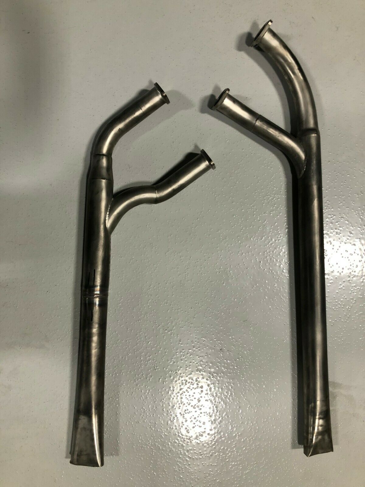

EBAY EXHAUST 12 14 2020.jpg (234.96 KiB) Viewed 23713 times
These are on Ebay -- item # 202981870839. I don't know the seller nor anything about the exhaust...a bit pricey, but they do look good and you'll likely find that any "repair" to yours may be a bit pricey, too. FWIW. Also, is your "triangular" exhaust bracket in good shape? If not, there's usually a repro for sale @ Wag Aero, 'though not "approved", they work and fit well. (...can't answer RE the holes, but the pinched ends are like OEM.) Mac
On edit, I see another set on Ebay -- #143659505641. While they don't look as good as the above, they're 1/3 the asking price & represented as being in good shape. Again, FWIW.

Need to chew on that, the second ones don’t look as good as what I have except for the flange on mine. I’d pass on them.
I called Acorn, price was between $600 to a max of $925 ea side, and maybe a couple of hundred bucks shipping as they are in Canada.
Do most exhausts have welded flanges like the first set on Ebay? my flanges slide and are not welded in place, it would seem that fitment may be an issue if they are welded.
Neither of my exhausts have any kind of braces, they only attach at the exhaust port. I don’t even see how braces could be fitted?
With Acorn I’d be sure of a quality exhaust that would fit, but at maybe $2,000 too.
