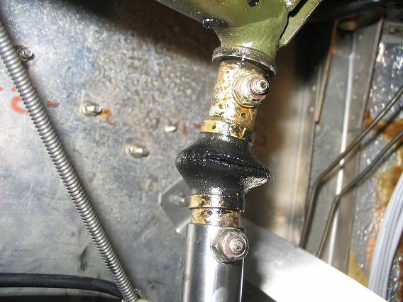

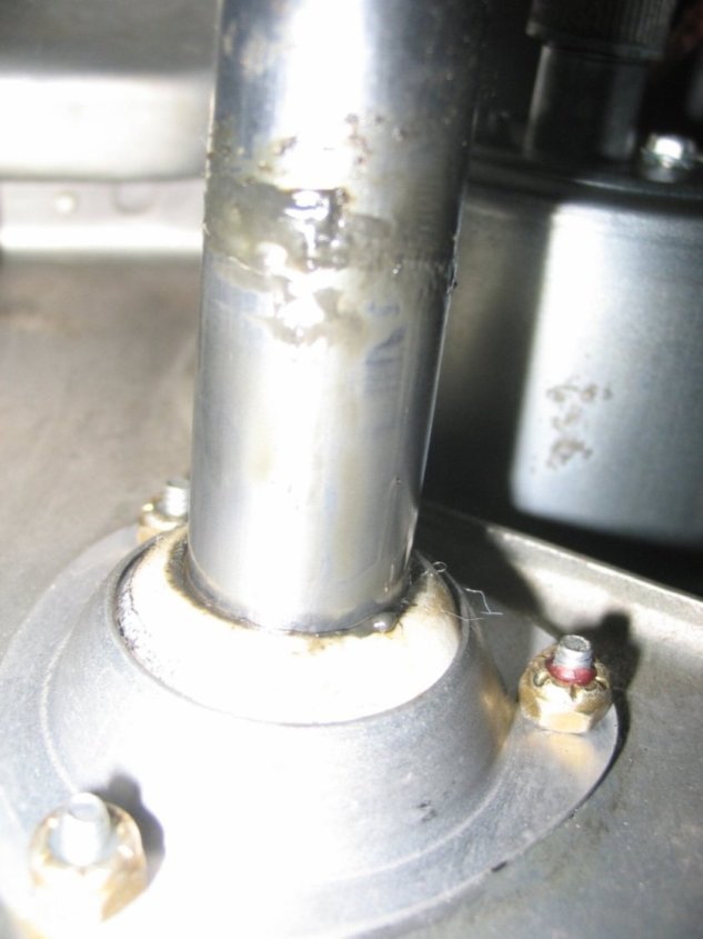

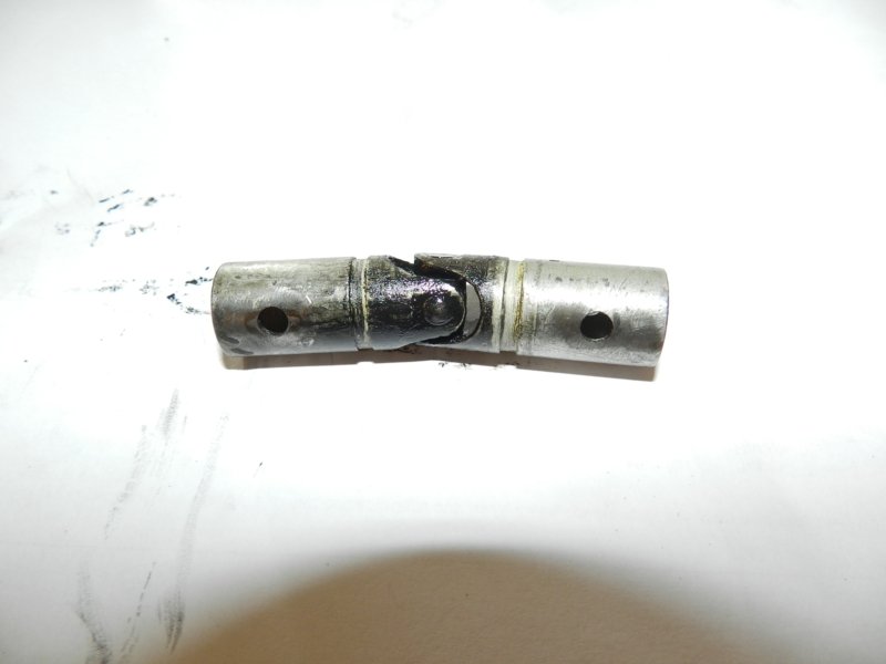

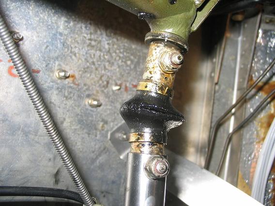

Be sure to check the u-joints in the control tubes -- some slop can come from wear there, plus if the tube "guide balls" are worn it can increase "sloppiness" feel. Mac

u-joints under panel... new boot covers from McMaster-Carr replaced the old ones...
Control yoke teflon ball (from back of panel)

The one control shaft has the slop/play just forward of the u-joint boot and the other shaft has the play where it connects to the control T. I probably need to remove the little boot to take a closer look.
