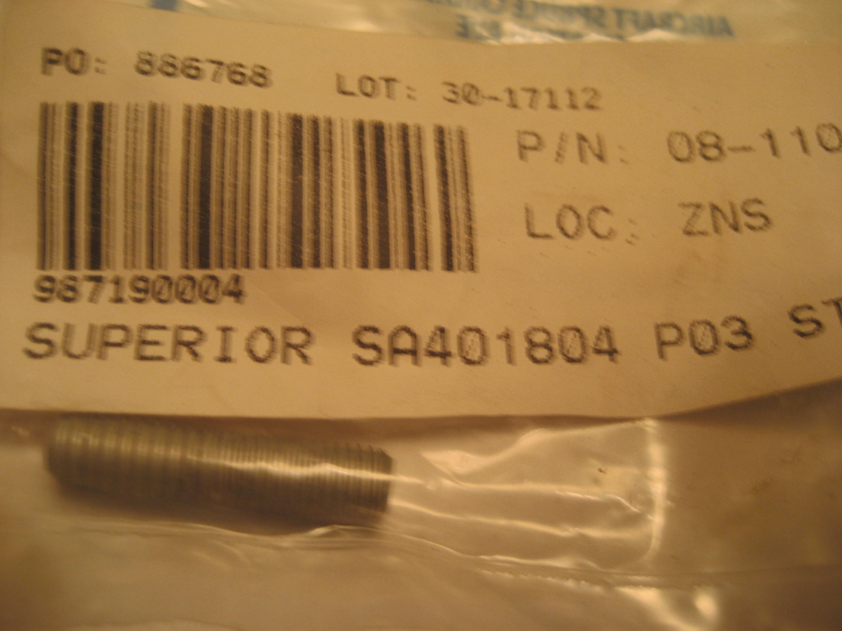

Here's the current stud:

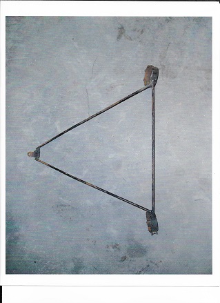

...and, here's a pic of the bracket. It'll fit to the rearmost stud.
EXHAUST BRACKET RESIZE 3.jpg (46.54 KiB) Viewed 3763 times
Jody wrote: "I assume these studs that have been in place for 77 years can be removed by using two nuts and simply unscrewing it?" Yes, but for the ones that screw into the magnesium accessory case, that is some tough stuff. I've heated (heat gun -- no flame!) before removing studs...and, that may or may not help, but I haven't broken one...so far ;) .

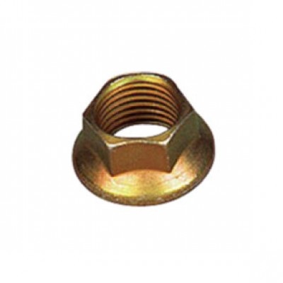

Those are not very good nuts.
The MS nuts John uses are I believe the high temp nuts you see holding turbine engine hot sections together, their silver color comes from them actually being silver plated for high heat resistance, they are a strong nut and really not expensive, and are pretty corrosion resistant as well.
This is a pic of them, these are only 10/32 and not 1/4” but otherwise pretty much the same.
