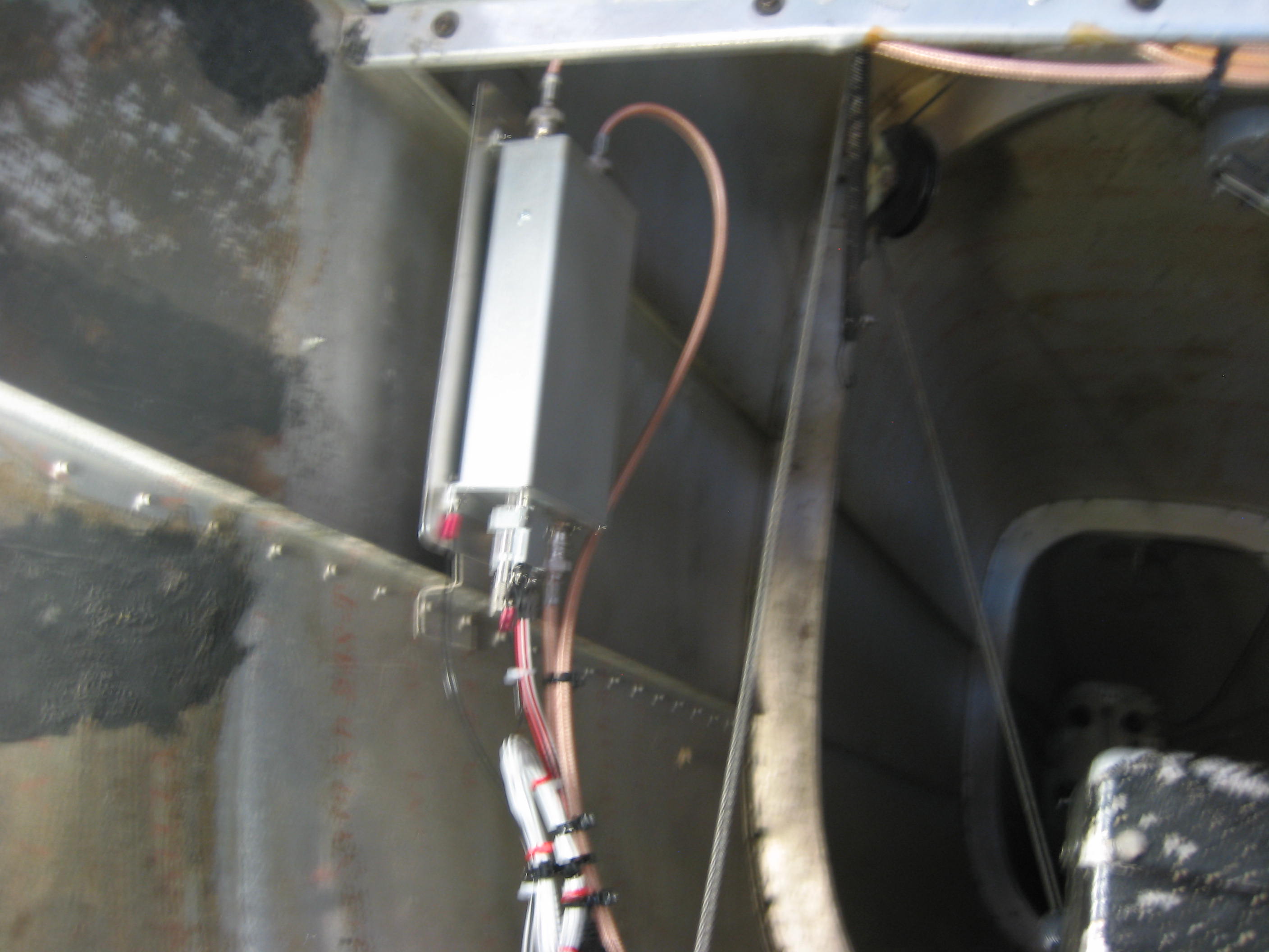

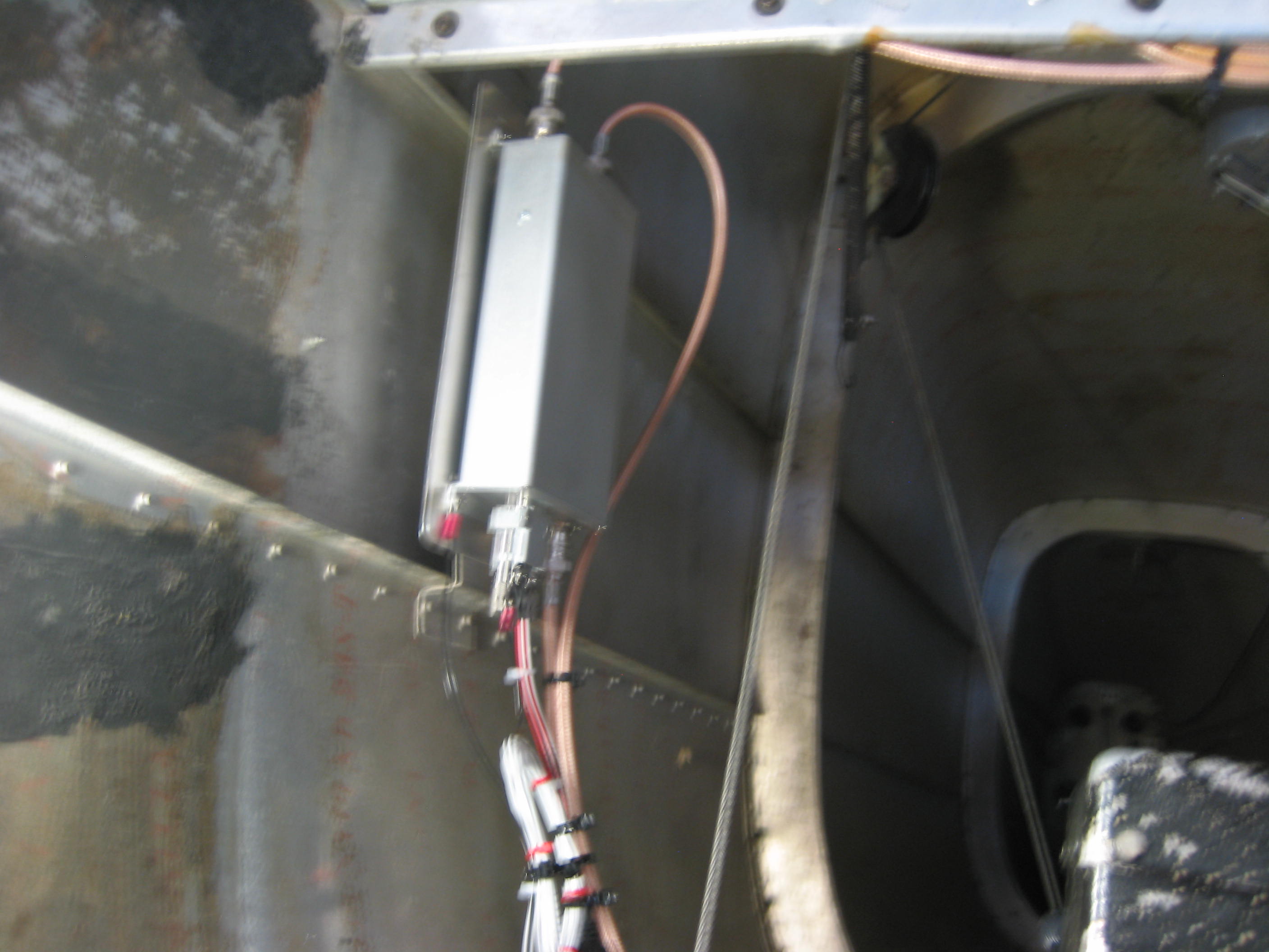

It will most likely either be the tail beacon as I have Whelen wing tip strobes, or the Garmin GDl-82.
Garmin is cheaper and I have a 327 xponder, but it requires more of an install, holes in the airplane etc.
Still trying to wrap my head around why the tailbeacon is an STC and requires a 337, for what is not a major modification.
Re: FAA approved fli
Posted: Mon Dec 28, 2020 3:03 pm
FWIW, my GDL82 has performed flawlessly...installed in '18 (My Txp is the 327 also). Harness fabrication is no biggie, but if you order pre-fabbed it's a (relatively) easy install, 'though you do have to add the GPS antenna on top and run that coax. The tailBeacon is very attractive for simplicity of installation & they seem to work well. Mac
Posted: Mon Dec 28, 2020 4:32 pm
by 8233
I went with the Stratus ESGi. It also required a GPS antenna installation. One of the reasons I went that route was that my existing Narco transponder was starting to fail and I was looking at a new transponder either way so I went that route which was the cheapest way to get ADSB In/Out at that time.
