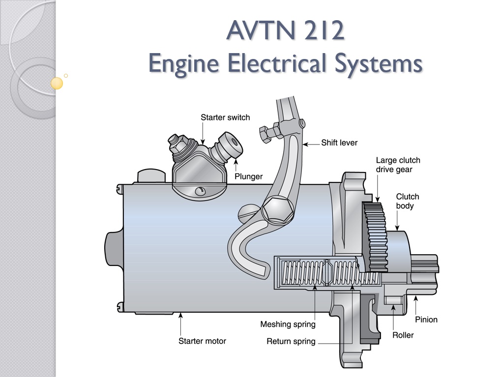

The reason the inner and outer shafts move independently is so that you can continue to move the lever to engage the switch even if the gears clash and don't engage. If they don't engage, the outer plunger is blocked. Continuing to move the lever compresses a heavy spring inside the plunger. pressing the drive gear against the cam gear. As soon as the switch closes and the teeth start to move, that spring forces the gears into engagement. (There is no inner shaft, per se, just the spring.)
Here's a picture from my engine electrical lectures:
pull start.jpg (134.64 KiB) Viewed 9226 times
The return spring is compressed by the pin in the engine case as the gear moves into engagement. The meshing spring is heavier and is compressed by the tip of the lever if the gear cannot move.
