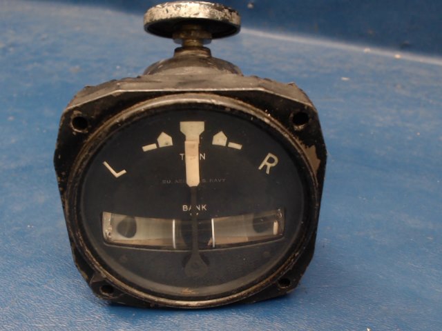

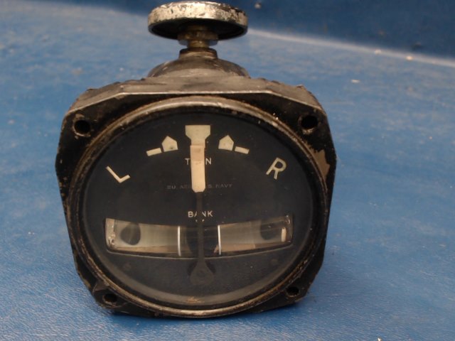

In the pic below, there is a disc screwed into the rear of the T and B (Vacuum) What is the disc for?
T and B.jpg (47.02 KiB) Viewed 2895 times
Re: Thingy on top of Turn and Bank
Posted: Mon Jan 11, 2021 4:54 pm
by a64pilot
God that thing looks as old as the WWII instruments that were in mine.
My guess is that it’s a valve so that you can change the amount of airflow through the instrument. But that’s a guess.
I’ve never worked in a Vacuum T&B, does it only have one hose that goes to it? If so then could the disk hold an air filter?

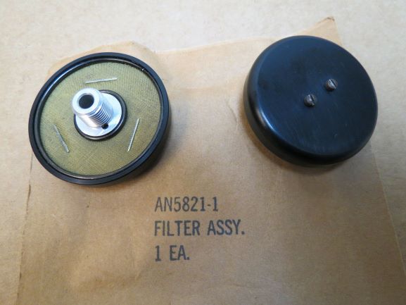

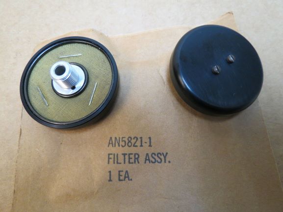

I found this image online from a 1940's manual. Looks like the "thingy" could be a filter.
Gregg
Posted: Mon Jan 11, 2021 6:44 pm
AN TURN AND BANK AIR FILTER.jpg (265.54 KiB) Viewed 2873 times
Posted: Mon Jan 11, 2021 7:23 pm
Yup!
Take the staples out and change the paper with bits cut from a coffee filter.
