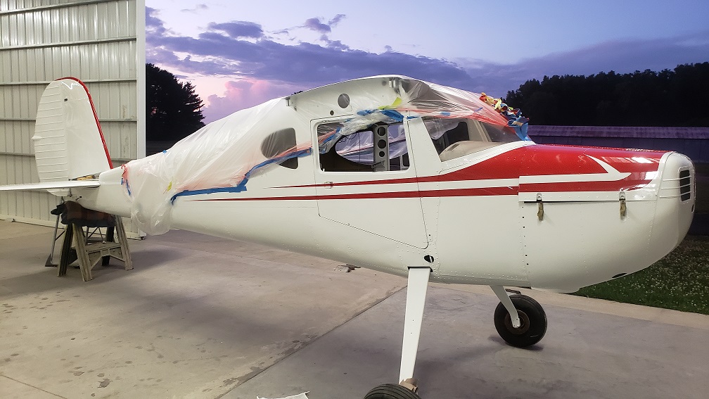

Hello All,
I'm in search of some guidance. I'm putting together a 140. I just finished the fuselage and paint and moving to the firewall forward. I have a C90 that came with this project and was told was the engine that was one it. Last known flight was in early 80's. Any how, in doing research for hardware, engine mounts, and etc. I realized that my C90 is a -16F model with a vacuum pump drive. The TCDS only allows for a -12F or -14F. I've searched the forums here but haven't been able to produce any results for this matter. I'm thinking a field approval should be relatively easy considering the minor differences between the engines. Has anybody run across this? Any all all advice is greatly appreciated.
140 25.jpg (189.66 KiB) Viewed 5413 times

Nice shot and good project, nice to see another 140 revived. For the vac. pump I simply trimmed out a hole in my cowl and let the pump stick out slightly, its hardly noticeable and provides for cooling. On the engine you might consider an O-200 at this stage if you can find one, I sold my as removed C85 and bought a runout 0200 for about the same price 3 years ago, the cost for overhaul of C85 vs O200 is about the same ( I don't know what shape your c90 is in). As far as the legality of the C90 engines I would think this a minor problem with a competent IA able to figure it out easily with the FAA records.
