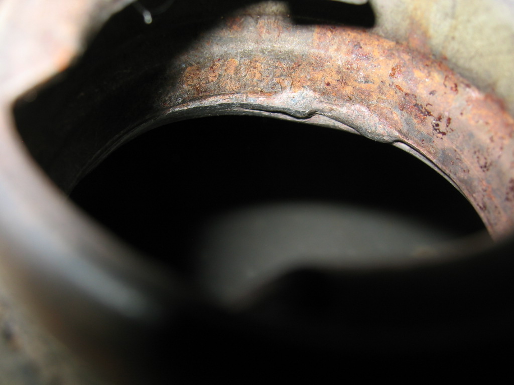

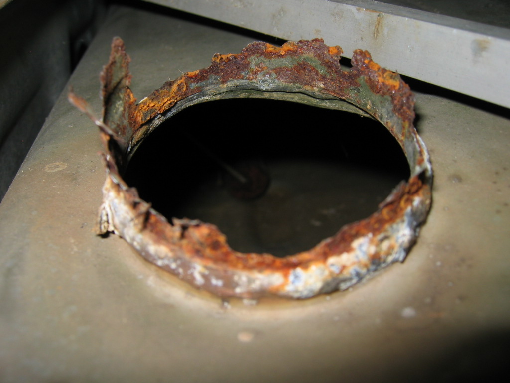

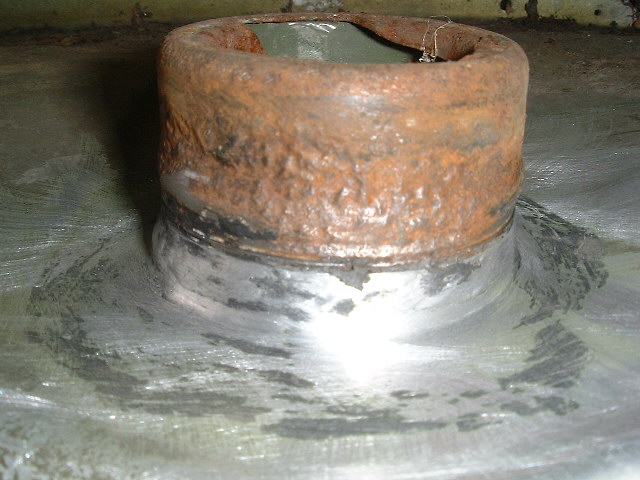

I went through this years ago, but I don't recall if it was Cessna tanks or something else. Anyhow, the way the tank was constructed, a steel neck was fitted into an aluminum tank and the parts were "fused" together by melting aluminum into the joint, sort of like a cross between welding and soldering.
- Posts: 2800
Re: Airworthiness shop or Repairman for Wing Tank Repair
I guess it was Cessna. Here are some pics from the old forum.
- fuel_neck.jpg (83.36 KiB) Viewed 7904 times
- img_1866.jpg (159.07 KiB) Viewed 7904 times
- img_1862.jpg (136.67 KiB) Viewed 7904 times
- Posts: 2800
the steel flange is threaded and the welding or brazing rod fills in the threads.
