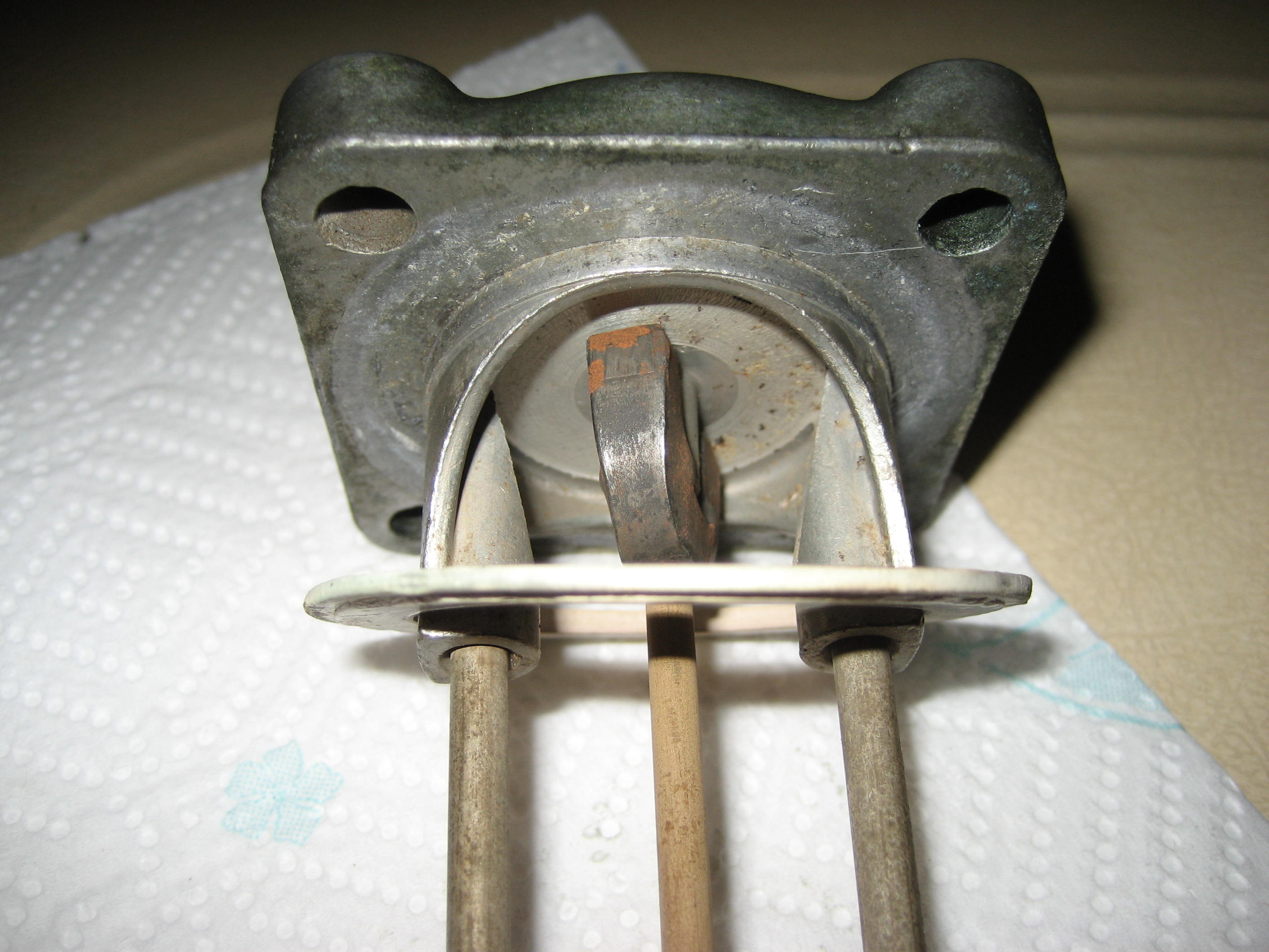

Here's what the back looks like as you pull it out:
Spruce also carries the gaskets for our gauges -- it's their Part# 15-4. (Also available from some LP Gas suppliers, incidentally)
And, just a note of caution (from having worked around bulk oil jobbers in another life) -- be wary of static spark potential when removing/installing. There's evidence that gasoline fumes may be much more explosive than the liquid fuel (and, as Randy admonished, be sure the fuel is drained). It's tough to rig any kind of "static bonding cable", but that would be "comforting" ;) .
Mac

2066 wrote: ↑Sun Jul 11, 2021 3:50 pm
Mac
Again, I went over to AS&S and looked for part 15-4 and was not very successful. Could you be a little more specific? I tried Scott (my fuel gauge brand) 15-4 but as I thought that brand is probably long gone and instead ended up with Scott tail wheels and other unrelated stuff. Is the gasket flat in its original state as it appears in your picture?
