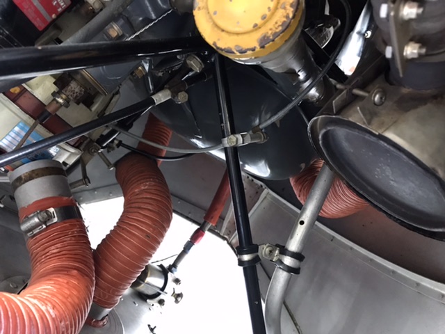

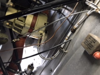

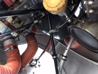

Hi all,
My engine is almost back from overhaul and I am sourcing some hardware for the installation.
I am installing 150 exhaust also. Can someone send me some photos of the routing of their mixture cable for the following configuration:
150 Exhaust
Marvel Carb
Thanks,

Re: Mixture Cable Routing
Post by 2356 »
2356
Posts: 143
Location: Gainesville, TX
Occupation-Interests: Retired
Post by 2356 »

Thank you very much.
