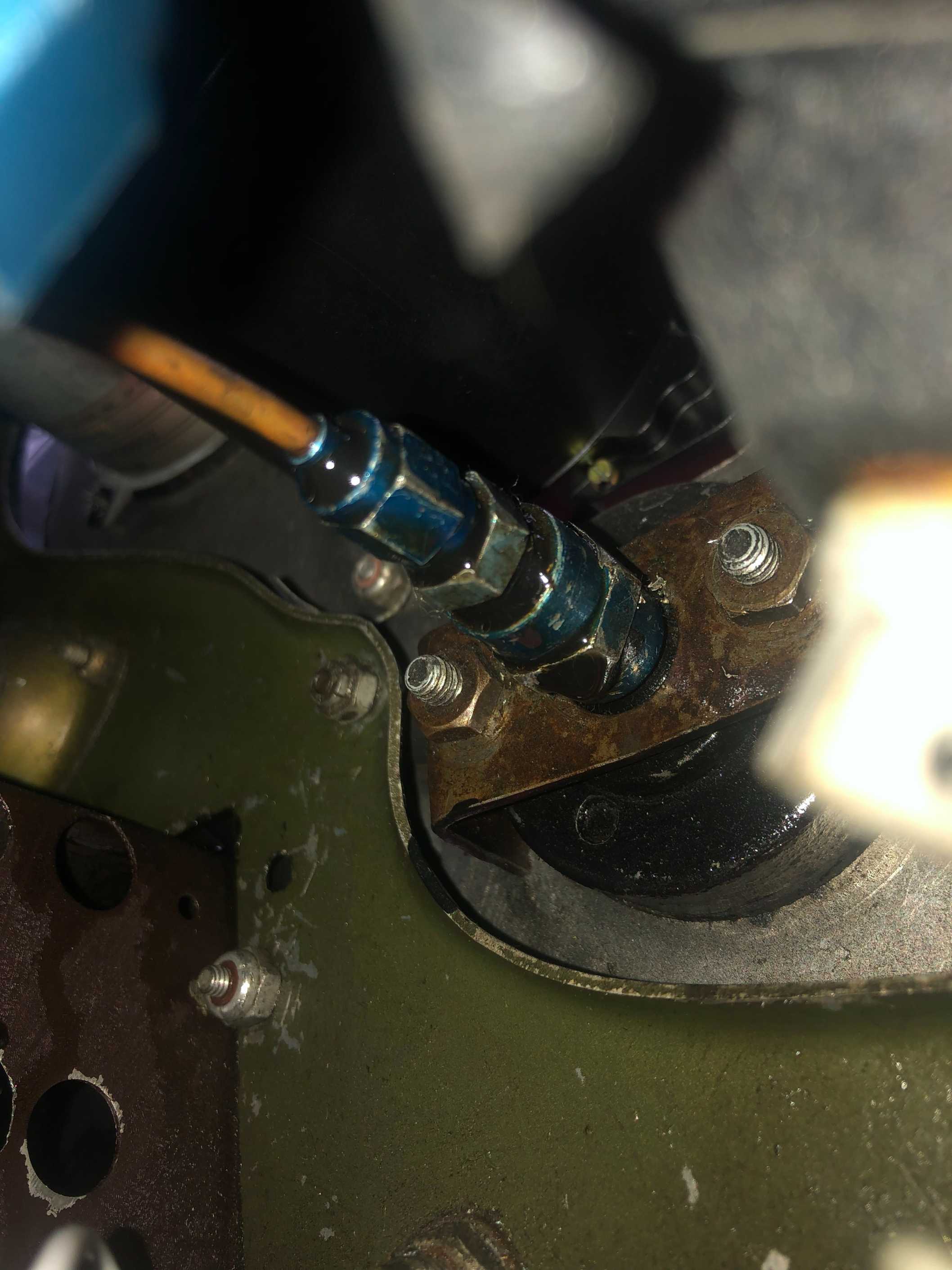

BTW, I found a very small oil leak from my oil pressure gauge during the ferry flight. I don't like the installation & I don't believe it's OEM fitting (see attached picture).

The fittings look about right, but they also look as if they have been abused in the past. They are standard AN fittings, easy to replace. Use a little thread sealer on the pipe threads and it should be leak free. You can remake the copper flare if it looks suspect.BTW, I found a very small oil leak from my oil pressure gauge during the ferry flight. I don't like the installation & I don't believe it's OEM fitting (see attached picture).

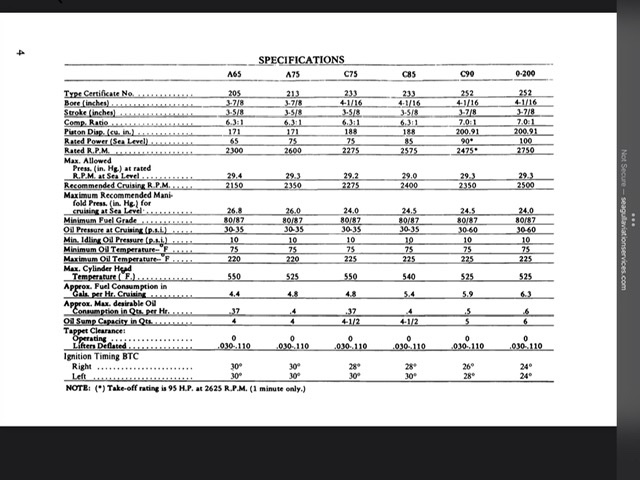

The bigger Continentals do just like the Lycomings, that is throw out oil above some set level, and interesting to me that level may vary a little from engine to engine.
Lycomings max allowed oil consumption is interesting, it’s based solely on HP
The following formula is used to calculate the maximum allowable oil consumption limits for all
Lycoming aircraft engines.
1. FIXED WING
0.006 x BHP x 4 ÷ 7.4 = Qt./Hr
So a 300 HP Lycoming burning 1qt an hour is airworthy, and going from memory the Continental IO-520 in the C-210 I used to fly was also allowed to burn 1 gt an hour, the 210 carried 90 gl without extended range tanks and would burn about 12 gl an hour at altitude, so theoretically it had an 7.5 hour endurance, and could therefore burn 7.5 quarts of oil, so you can see why that motor could hold 12 quarts when topped off, but above 9 or 10 it woud blow out the excess over time.
Now what Continental says is max allowed for C-85’s or O-200’s I don’t know, but woud be interested in hearing what it is if anyone has a reference, mine leaks more then it burns, I feel sure of that
Is it .4 per hour?
I’ve seen .4 and .6, but neither in a Continental publication.

a64pilot
- Posts: 319
- Name: Jody
Re: Min/Max Oil Qty o-200 - STC SA547EA
OK, apparently .4 for the C-85 and .6 for the O-200
