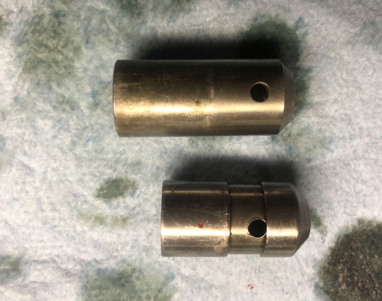

Oil Pressure Relief Valve Plunger - Not all created equal!
Enough time has gone by that I feel reasonably confident in presenting a follow-up post regarding my earlier oil pressure problems.
In desperation I ordered a used plunger, Part Number 21114, from - you guessed it - eBay. When it arrived I discovered that it was significantly longer than the original plunger. I installed it with the standard (new) spring and my oil pressure has been steady in the 50 -60 psi range ever since.
I believe that the original shorter version was prone to sticking open, and at some point Continental changed to the longer design to address this problem, without changing the part number.

Re: Sticking Oil Pressure Relief Valve
Thanks for the info.
