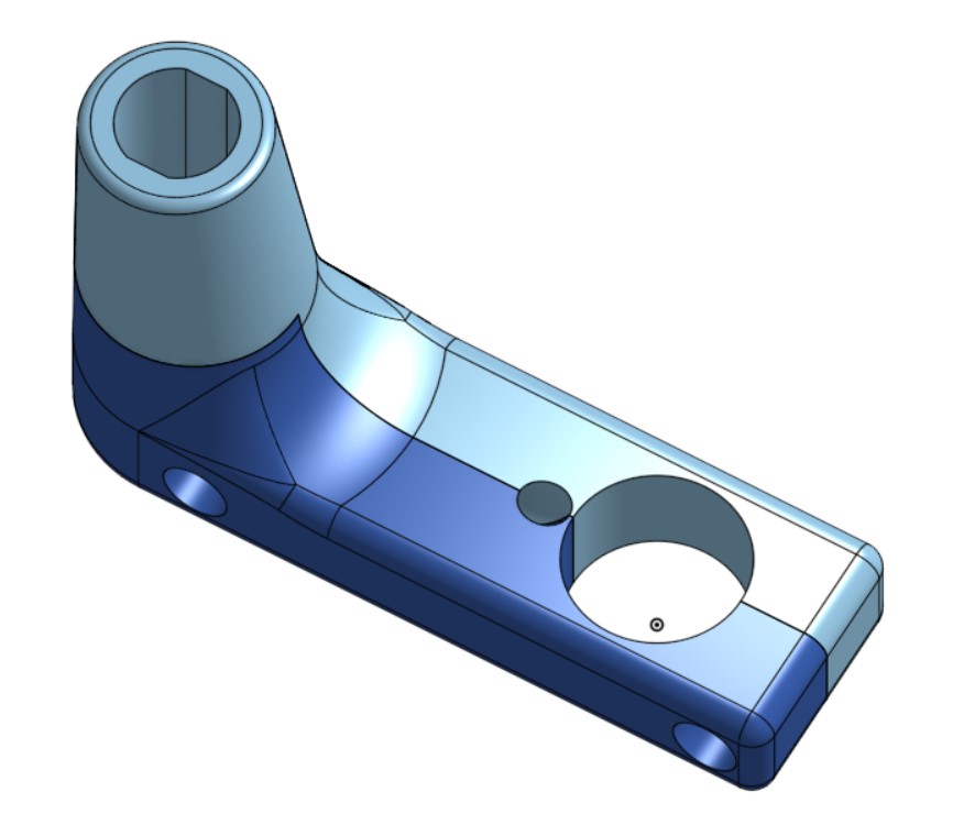

I don't have any good shots of the back, but I do have a shot of the model. The whole assembly is pinned together with two screws and imbedded nuts and the wires for the PTT stick through the little hole and go inside the pretzel yoke.
Not sure if they would be a big hit or not, but it would be around $50 ea + shipping If I were to do a batch run of these. Not terribly cost effective.
PTT Model.jpg (53.73 KiB) Viewed 7124 times

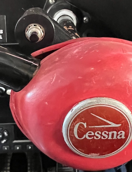

PLA printed design of PTT switch on pretzel yoke.
PTT Front View.jpg (89.04 KiB) Viewed 6746 times
