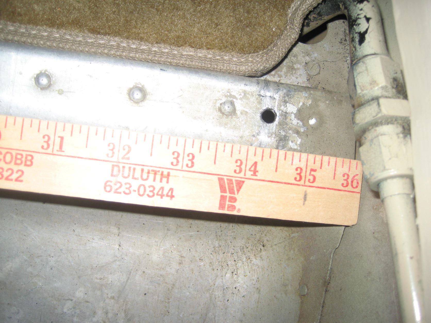

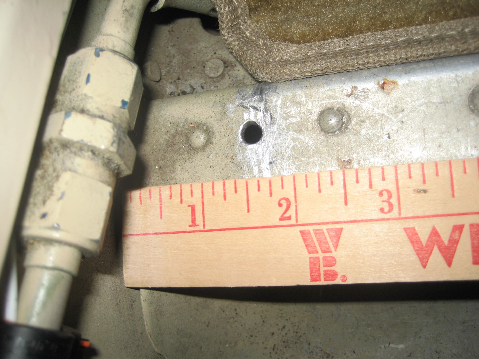

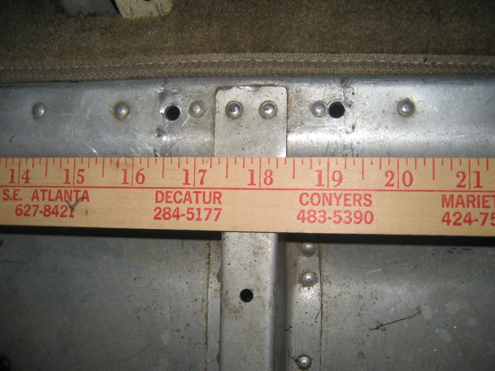

Re: Seat frame holes
RIGHT SIDE
RIGHT SIDE
CENTER
CENTER
LEFT SIDE
LEFT SIDE
Hopefully these will help a bit? If you need more, or if you need measurements...let me know. I haven't got that 'rountoit to compare floor pans with neighbor's 140, but will do ASAP & report. Hope this'll help. Mac
Post by 8342 »
Thanks Mac.
That should do it.
