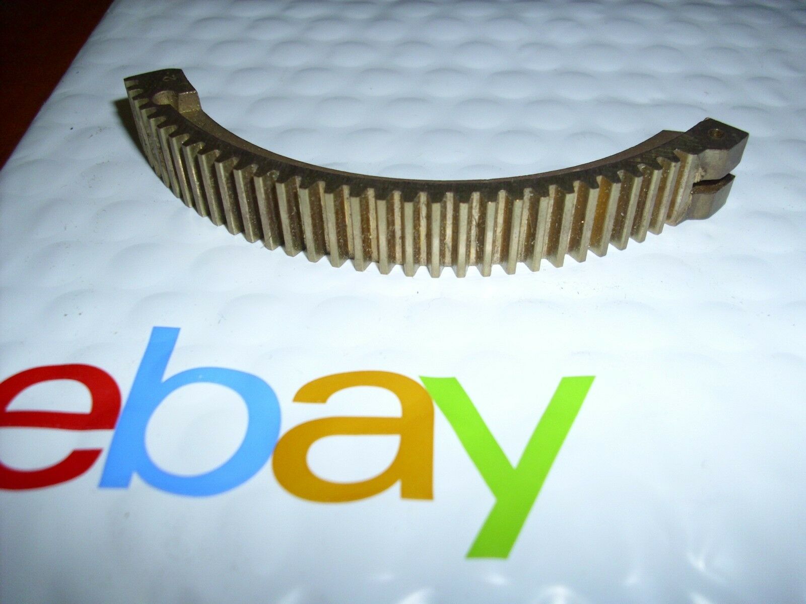

There's usually a boat load of Grimes lights and some parts on Ebay -- it's good to have part #s and/or photos handy to sift through them -- there were lots of models. That said, most seem priced so far out of reason that they never seem to sell, just relist 'til someone really needs/wants! :roll: . An example & one that's actually priced well @ $15.00 (...and, I realize that this isn't one of your broken parts):
grimes gear.jpg (158.73 KiB) Viewed 9561 times
The leading edge sure seems to be most practical all'round...but, I sure do like the "old timey" retractable on my 140 (...with a "modern" LED bulb). Hope it keeps on working!
