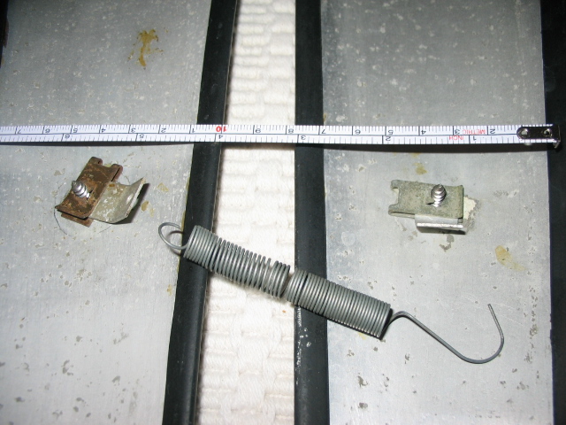

My setup, nothing fancy, make sure when you adjust the tabs that the spring doesn't interfere with nearby control cable...
- 12-14-08 004.jpg (164.5 KiB) Viewed 2147 times
