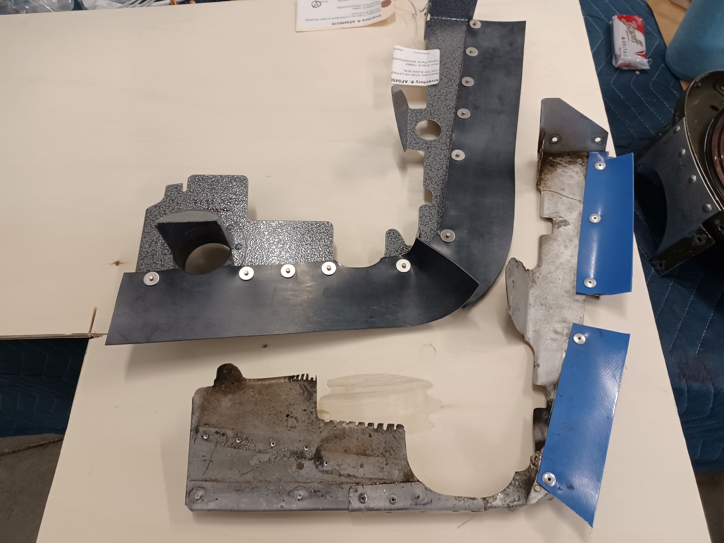

Steve, I would be very interested in seeing the photos of your new baffling. I ordered a set, but my engine is still out for overhaul, so we haven't had a chance to fit the engine, baffling, and cowling all together yet. I'm anxious to see if it all fits together nicely, or if it's going to be a pain in the neck.
One thing we have already encountered is that the Left Forward Baffle Assembly from Airforms does not match my 1946 baffling. The newer Airforms baffling has an air scoop and a smaller cutout for the "inlet" into the carb heat shroud on the straight exhaust. My mechanic has brought this to their attention, and we are discussing with them what to do next. Kudos to Airforms for taking the time to listen to our concerns. (We've had some rude encounters with other vendors in the past...I'm looking at you, Sensenich...)
My email address is cfblanc at yahoo dot com.
-- Chris B
