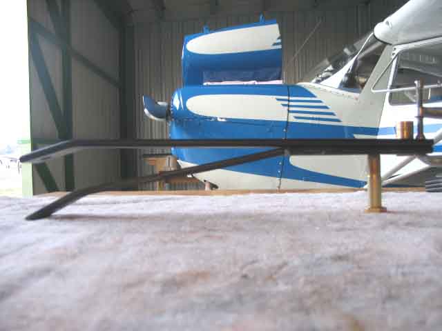

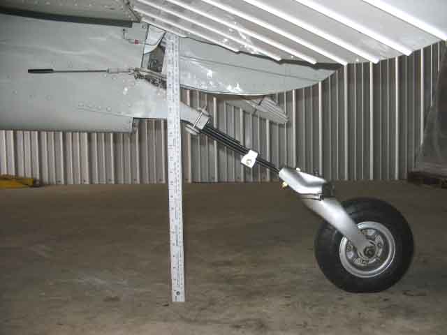

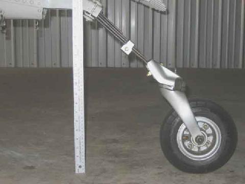

I can show you the differences but I cannot explain the 'why'. As far as I can tell the mount at the fuselage remained the same and was installed the same across all serial numbers...
The single and double bend springs next to each other
Double bend spring on early serial number, note how high the tail is....
Single bend spring on early serial number, note the overall height decrease...
