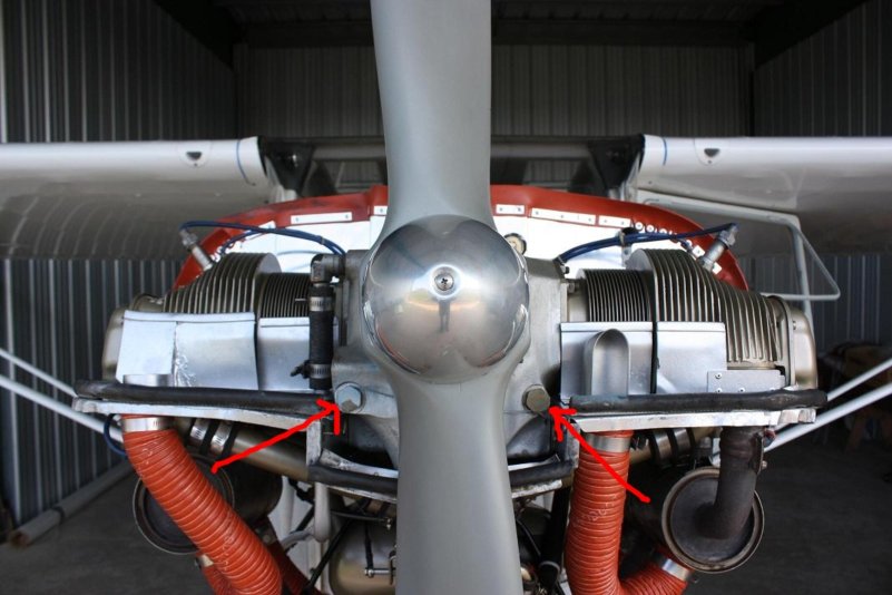

Anything like these useful? My 0-200, don't know the story on the 85's
0-200 plugs.jpg (76.86 KiB) Viewed 2461 times
Re: crankcase breather elbow
Posted: Tue Apr 26, 2022 3:59 pm
Those are your main oil galleries.
