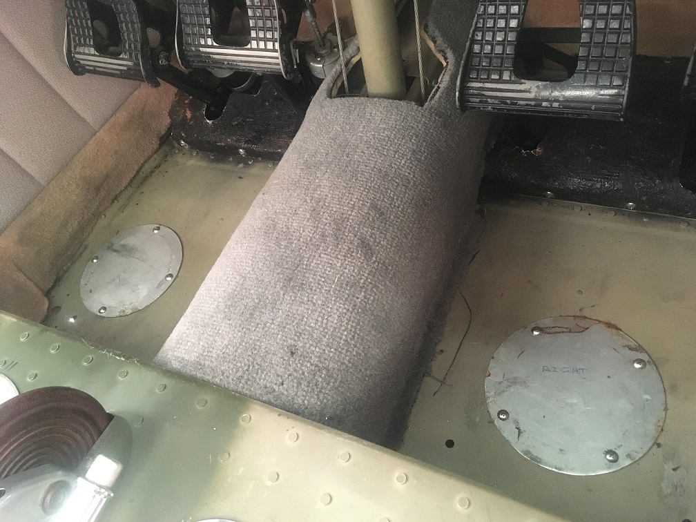

Hello everyone, my airplane has circular inspection covers on the floorboards just forward of the seats. I took them off and didn't see anything that might require inspection or service. Are these inspection holes common? Or was this a field mod for some reason?
Cessna 140 N76415 floorboard covers.jpg (307.31 KiB) Viewed 2689 times

Those are not original.

Mine has the same. My plane also had weld repairs done to the gear after a ground loop around 50 years ago. Perhaps put in for access?

I had a mouse nest in there, now I have an inspection cover...

6643 wrote: ↑Fri May 06, 2022 3:40 pm I had a mouse nest in there, now I have an inspection cover...
Not original...........the only thing those access would be lost hardware when you're working on the rudder bars/brake master cylinders etc and loose hardware and it rolls down into that space where there "was" no access to get it out.........
Or........in John's case.........."Critter removal"

I have one on the passenger side that I used to take pictures, back in the day when slides were the thing. Aerial Servey work..
