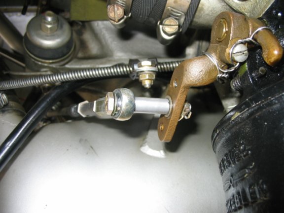

6597 wrote: ↑Wed Jun 01, 2022 9:31 pm I had to adjust the linkage to drop it back a little.
I don't understand what you're saying, unless you mean you limited the throttle to less than full open, in which case, well. static RPM is measured at full throttle...

Yes, I limited my throttle 'throw' by adjusting the connection, you are absolutely correct. I don't like it but other than re-pitching the prop it's the only option I have in the short term. Regardless, I think my 'new' engine has more ponies than the old one.

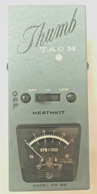

As far as checking the tach my ancient HeathKit analog handheld tach says all is correct, however my A&P friend has a more modern unit that I will check with.
