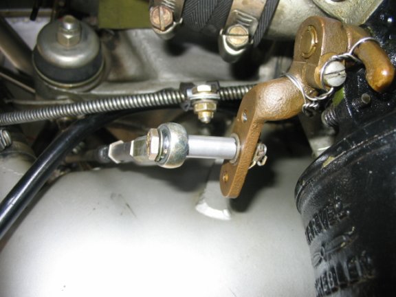

I know my static rpm jumped from about 2300 pre-overhaul to 2450, I had to adjust the linkage to drop it back a little. Hate leaving power on the table, maybe a re-pitch will be in the future.

6597 wrote: ↑Wed Jun 01, 2022 9:31 pm I had to adjust the linkage to drop it back a little.
I don't understand what you're saying, unless you mean you limited the throttle to less than full open, in which case, well. static RPM is measured at full throttle...

Yes, I limited my throttle 'throw' by adjusting the connection, you are absolutely correct. I don't like it but other than re-pitching the prop it's the only option I have in the short term. Regardless, I think my 'new' engine has more ponies than the old one.

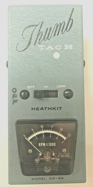

As far as checking the tach my ancient HeathKit analog handheld tach says all is correct, however my A&P friend has a more modern unit that I will check with.

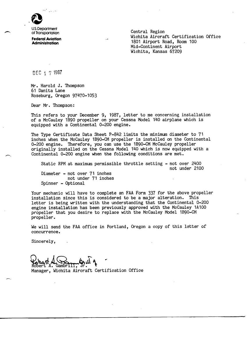

Here is the 337 response I have from Witchita regarding the particular prop I have, it's a 71/42 on the 0-200. My best guess is when an ancient owner decided to re-engine to the 0-200 he didn't want to shell out money for a new prop on the STC so he 337'd the McCauley he had. I can't complain on the performance but I do need to watch the overspeed when transitioning to cruise. The plane climbs like a rocket, 1100-1200fpm with me and full fuel at sea level where I'm at. Cruise is still at 2450-ish and 105mph indicated so I don't think I gave up much at all in cruise.
I think Randy has done his homework extremely well and his prop requirements and advice would be much more appropriate for the 0-200. This just happens to be what I've inherited and I've learned to live and work with it.
