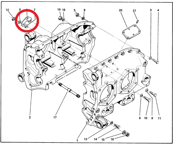

Hi,
I'm wanting to change my bushings as well. I'm not sure where exactly to hoist the engine from. The only thing I've found is lift from "lifting eyes" on backbone of engine - I don't think I have that installed or lift from the crankshaft with prop removed (ref. OH manual). C-85-12F.
Thanks!
Nick
Re: Changing Rubber Engine Mount Cushions
Posted: Sat Aug 20, 2022 10:53 am
lifting eye.jpg (97.44 KiB) Viewed 2418 times
Posted: Sat Aug 20, 2022 11:00 am
https://www.fresnoairpartsco.com/produc ... e-lifting/
Fresno Airparts also has the correct crossbolts and spacers.
