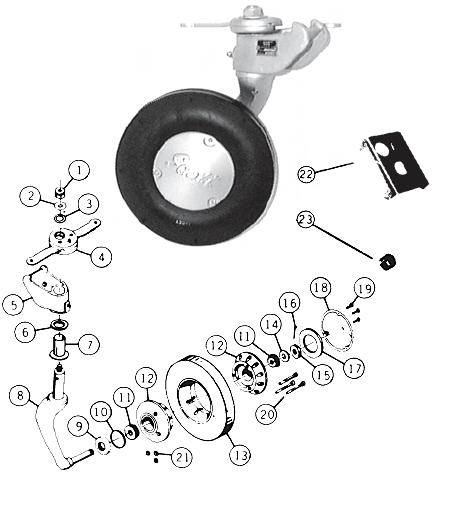

Some Scott 2000 reference material for your libraries...
- scottModel2000.gif (42.09 KiB) Viewed 4608 times
