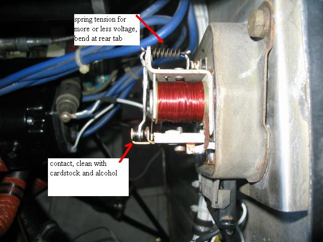

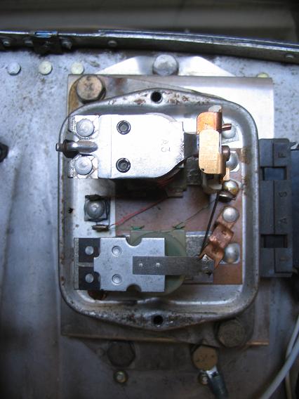

Mechanical voltage regulator contactors may need a touch up clean every now and then, card stock, fine garnet paper (not wet/dry silicon carbide), business card and alcohol. I have an old one and it is voltage adjustable (see spring tab on pics). Contacts arc and cause pitting which needs to be tended to. My Odyssey battery prefers a slightly higher charge than the electronic VR's can give.
If you don't have a sealed battery may want to check your battery box for boil over and get it cleaned up.
Of course if you have an electronic VR (like a Zeftronics) I can't help you, see Randy above...

The regulator in Dave's pictures is for an alternator. A generator's regulator will have three sets of contacts. Disconnect the battery before you mess with the contacts.
