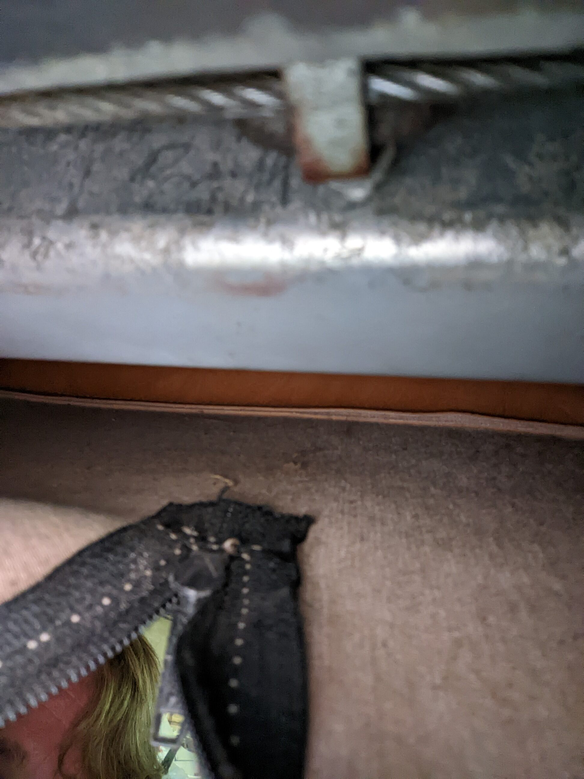

I looked at a '47 C140 today, and have a few concerns. It looked serviceable and like it was being taken care. Ragwing, needs some cosmetic work but flyable. I looked at the rear carry thru, and can't figure out what was done to it. It looks like it had been cleaned with something, and looked pitted. So, maybe it was cleaned and treated at some point? Not sure if that is an acceptable MOC or not? I tried to upload a picture, but can't seem to get it to work. The other issue is the engine, it has ~650 SMOH on it, but the overhaul was done in ~91. So that is a slight concern too, I could get lucky.
I will try and get a picture posted, I know my description is not much to go on, any help would be appreciated.

Don’t know the limits on the carry through spar. My IA had a wing off for a fuel tank repair. Announced he was going to take a look at the spar. I went an hid in the corner of the hanger with my fingers and toes crossed. It was fine, actually looked great.

You need to look for delamination of the spar carry through. Delamination will be most prevalent at the edges. Especially the forward edge.
If it has been over on its back from a landing mishap, look at the forward spar carry through for being bent.
That is what I found on mine and what ultimately became a ground up restoration. I ended up replacing both of mine for these reasons.

Thanks for the advice on the picture, resizing the picture worked.
The last annual shows the compressions in the 70s, the logs show that a couple of cylinders have been replaced in the last ten years. This was my initial look, thanks for the info so far. I was planning on a pre-buy, the plane is at York, PA. Any good recommendations for a mechanic in the area?
