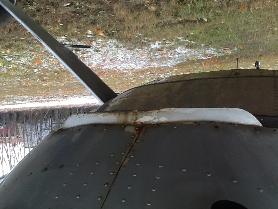

Re: Summer lower cowl lip 0452199
I snapped this picture today of a 120 cowling with the cooling lip installed. If memory serves, the lip lowers oil temp on this particular plane by about 10 degrees. It extends about an inch below the cowling at roughly a 60 degree angle.
- image.jpeg (264.78 KiB) Viewed 3548 times
- Posts: 575
That gives me something to play with, I'll size it up during my oil change this afternoon, thanks!
