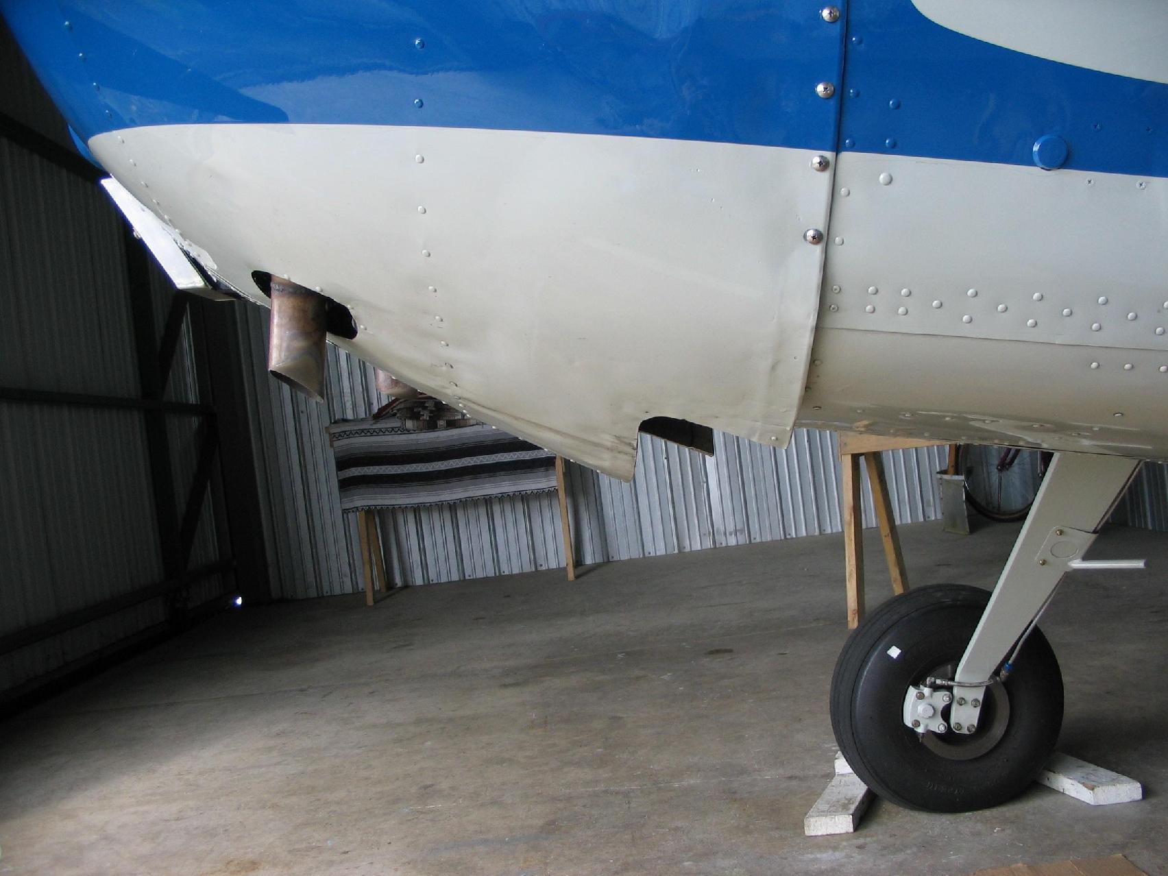

I know there are different lower shapes, I thought there were only 2. Here's what I have, supposedly early 1946, been on it's nose at least once I'm sure in the past. If had a pattern I might try my hand at making one but I'm not really a sheet metal guy.

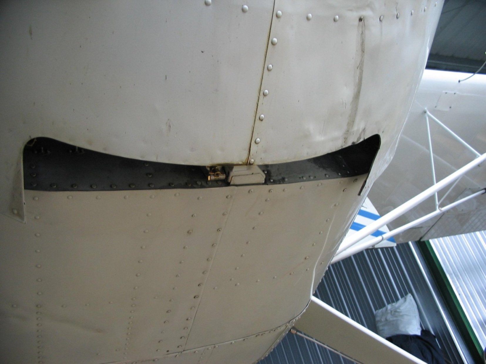

I snapped this picture today of a 120 cowling with the cooling lip installed. If memory serves, the lip lowers oil temp on this particular plane by about 10 degrees. It extends about an inch below the cowling at roughly a 60 degree angle.

Posted: Tue Oct 11, 2022 10:19 am
That gives me something to play with, I'll size it up during my oil change this afternoon, thanks!
