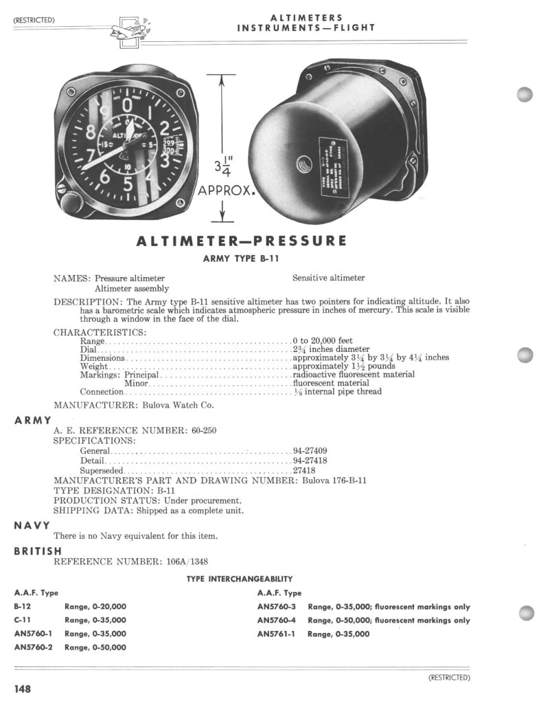

I'm not saying you're wrong, but, the 120/140 predate the concept of "TSO" so the originals were not "TSO'd". Also, the "Sensitive" altimeter was optional. (The "insensitive" ones had 100 foot graduations.)
The question has been floating round the internet since the beginning, without resolution. My take is the TSO lets the A&P off the hook of deciding if the instrument is acceptable or not.
(BTW, the Bulova part is a military part and doesn't appear to have a TSO tag, nor is it original...)
I found this online, I agree probably not original to the plane but apparently built 3 years before it. The instrument shop says it's probably a Kollsman model made by Bulova, they will cross reference the AN numbers for their paperwork. I like the history.

I'd definitely use it. I was just pointing out that the "requirements" for what constitutes an acceptable altimeter for our planes are somewhat hazy.
