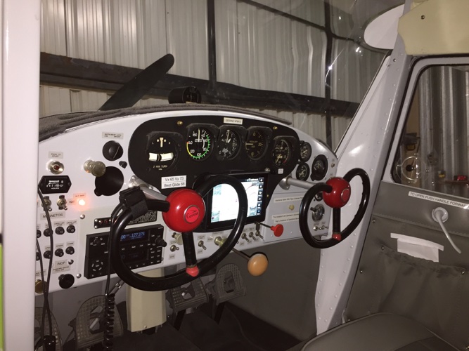

Wouldn't it depend on who makes the paint?
The same color from different manufatures using a different name.
Stewart system has four shades of grey but none that you mention.
For the interior of mine I used their Dawn Grey with good resultes.
I painted the gear legs white.

Beautiful panel. There can only be one color that matches 1949 Factory original regardless of paint manufacturer.

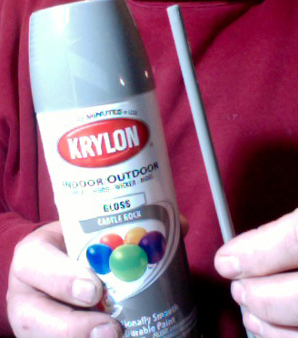

French Silver Gray available today for interior components
Here's the better priced one, the French Silver Gray is very very close to Krylon Castle Rock Silver Gray aerosol canned paint. Your Lowes or Ace Hardware stores should carry it.
