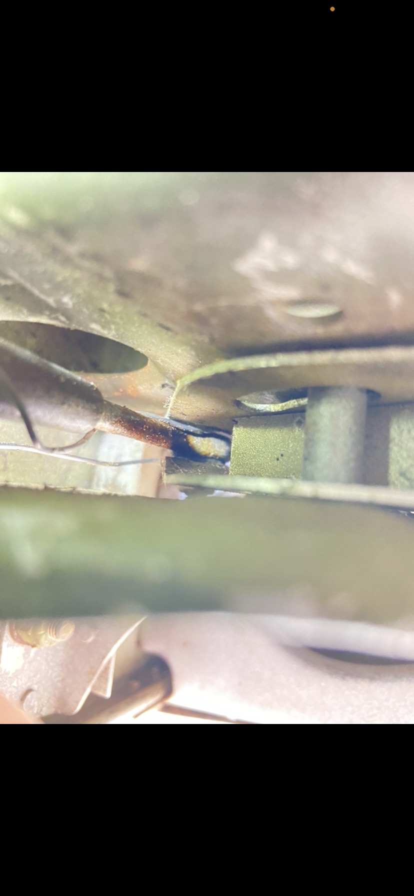

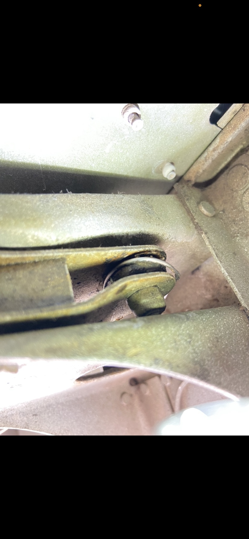

Here’s a few pictures. In the 2nd picture, you can see where the old safety wire was actually chaffing on the aileron control horn… The safety wire in the pictures is only to show the path. I have yet to finish the safety.

- Posts: 746
Re: Safetying RH Balance Turnbuckle
You're on the right road.......
