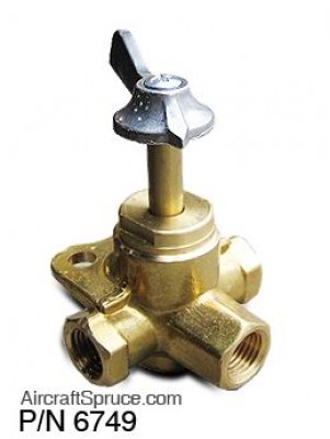

Posted: Tue Apr 18, 2023 9:41 am
Also, there's this "replacement" valve (below) -- inexpensive ($32.95), exact fit, bullet-proof durable and functions flawlessly for L/R/Off. The Imperial handle easily retrofits to the 6749 stem or the included handle is simple to modify for "pointing" properly. There are some among the fleet quietly aviating with it...for many years. As Si mentions, "the legalities of putting it in a Cessna" is an important issue, certainly, and in no way is this an endorsement. The rules surrounding the new "off the shelf parts for vintage aircraft" may still not allow an off-the-shelf valve(??)...or would they? Mac

by 6277
This is the old Weatherhead valve. There are some instructions somewhere on this site on how to cut the shaft down, grind the point off the handle and reverse it so the handle points to the tank selected. I did one for my 140 and it lasted about 6 months before it started sticking and became too hard to turn. I lubed it once and then it happened again shortly thereafte. I gave up and bought the current valve described in this string.
