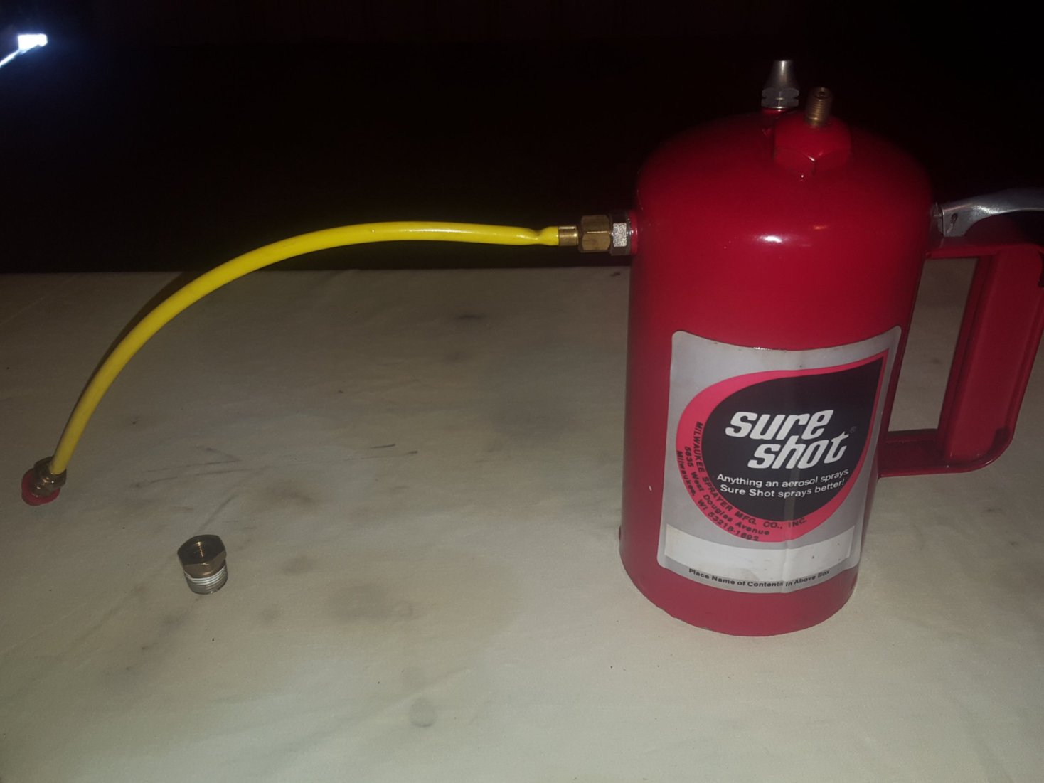

Thanks. The cylinders are Superiors - their service letter indicates to use mineral oil of the appropriate weight.
It also says to build oil pressure before starting. What is the best means of doing so?

Re: Recommended Break In Oil C-85
You might try turning the engine over without the plugs installed.

- Posts: 573
I did this on my recent overhaul, an oiler attached to a bushing attached to the front oil channel plugs. I think I did both holes until oil came out the oil pressure sender line.
