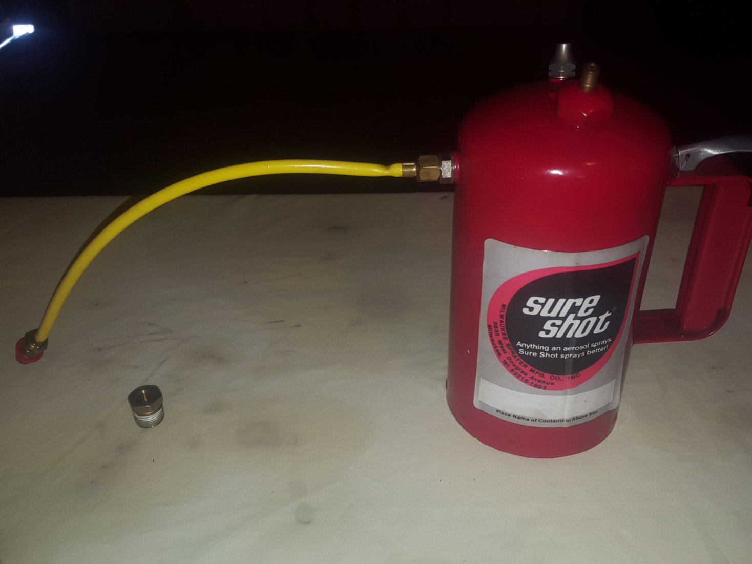

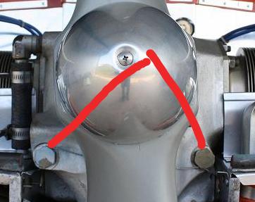

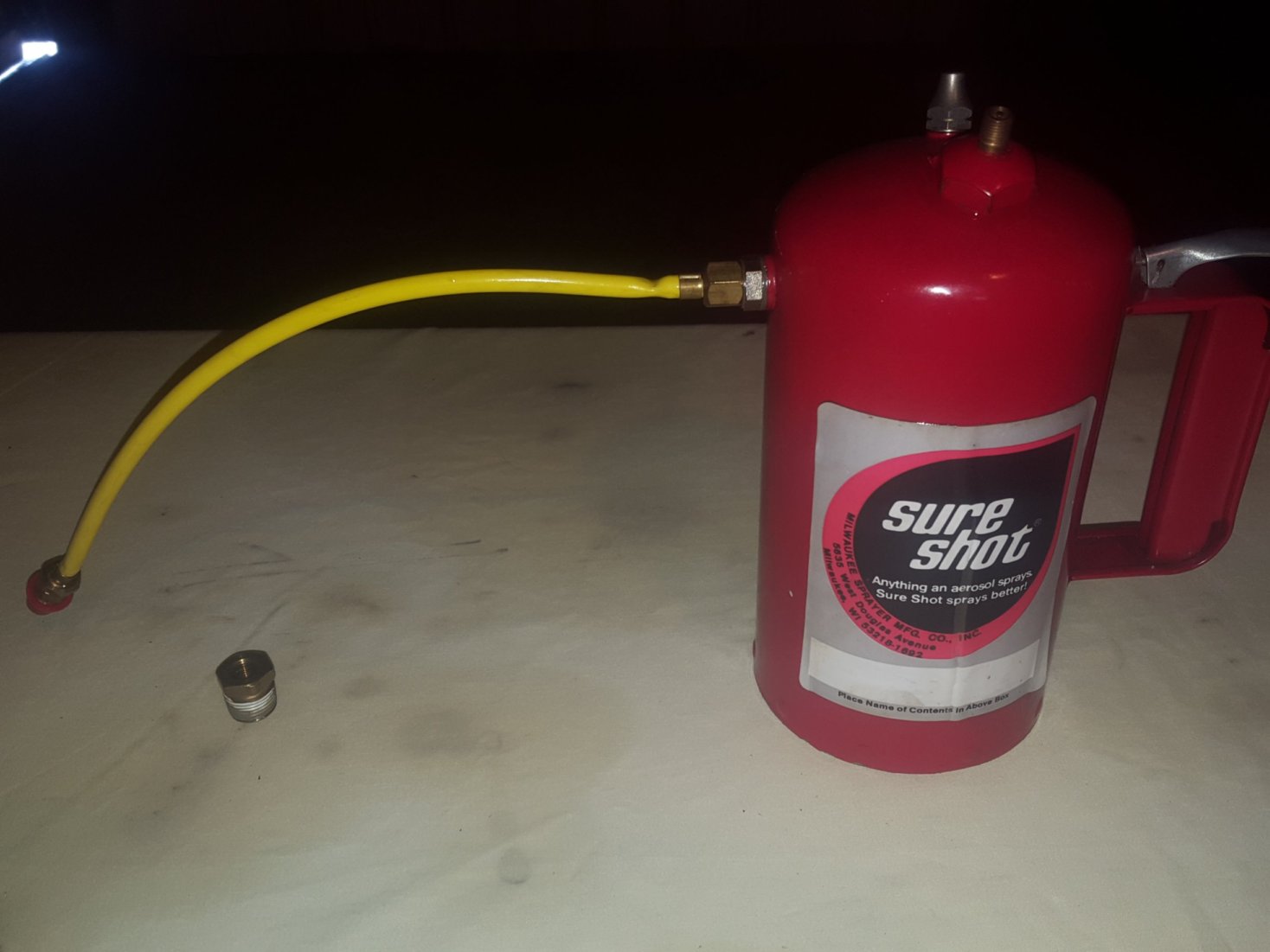

I did this on my recent overhaul, an oiler attached to a bushing attached to the front oil channel plugs. I think I did both holes until oil came out the oil pressure sender line.
