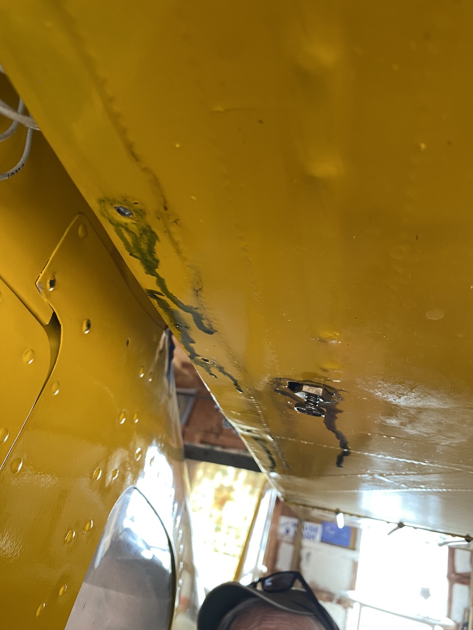

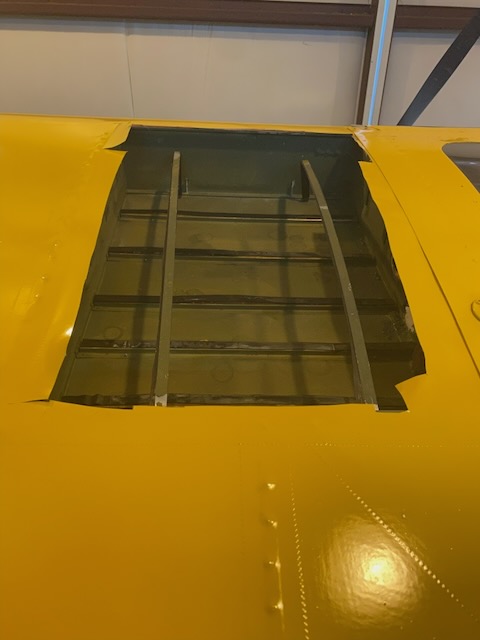

Oh man, I just went through this on the left side. It was a lot of troubleshooting and head-scratching until I bit the bullet and had the tank removed. Turns out there was a pinhole leak in the weld for the fuel line bung. Even under pressure, the tank never leaked, it just would weep. Every 24 hours I was wiping blue 100LL dye off the airplane. I thought I had it fixed after tightening the fuel gauge screws. I didn't have fuel on the side of the airplane after a flight, but I still had it the next morning.
Fortunately I have access to some great maintenance personnel, and the NC State Rep for The Association. Once we got into it, the repair was labor intensive, but fairly easy. We pulled the wing to make the fabric repair easier. The straps that hold the tank down are secured by phillips-head screws that go in from the bottom of the wing. The only "snag" we ran into was that the wings were painted with urethane a couple owners ago, so now I have a can of Poly-Tone on the shelf I cannot use...
  • First thing I did was tighten the screws on the fuel gauge. (Be careful the LAST thing you want to do is strip them!
  • Second thing I did was replace the quick drain -- multiple times
  • Third thing I did was replace the finger screen
  • Fourth thing I did was pull the tank.
Unfortunately, I don't have a picture of the tank.

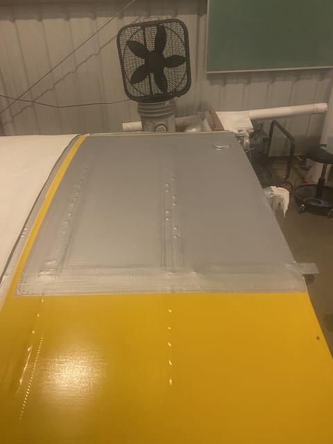

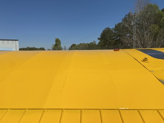

Finished Repair
