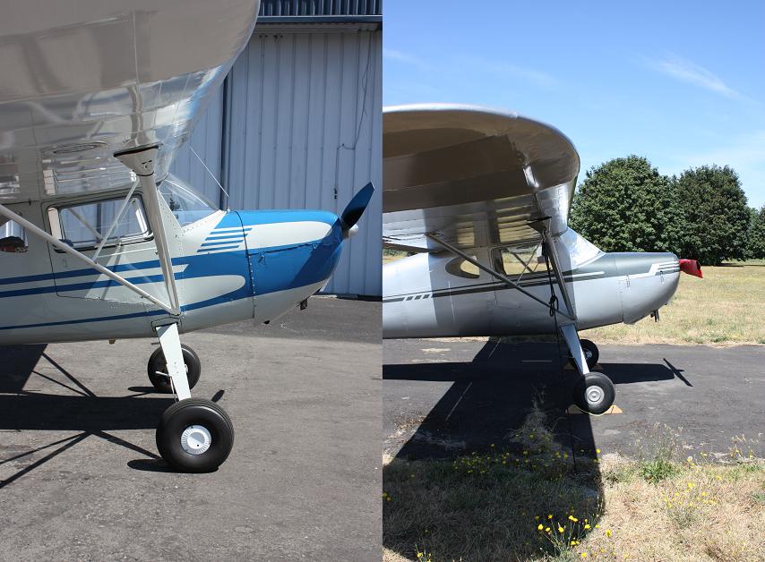

And a pic to see what they look like on the bird...grey/blue bird has straight legs, silver/green bird has swept forward legs.

Source for the strut cuffs seen on the two representative C120?
