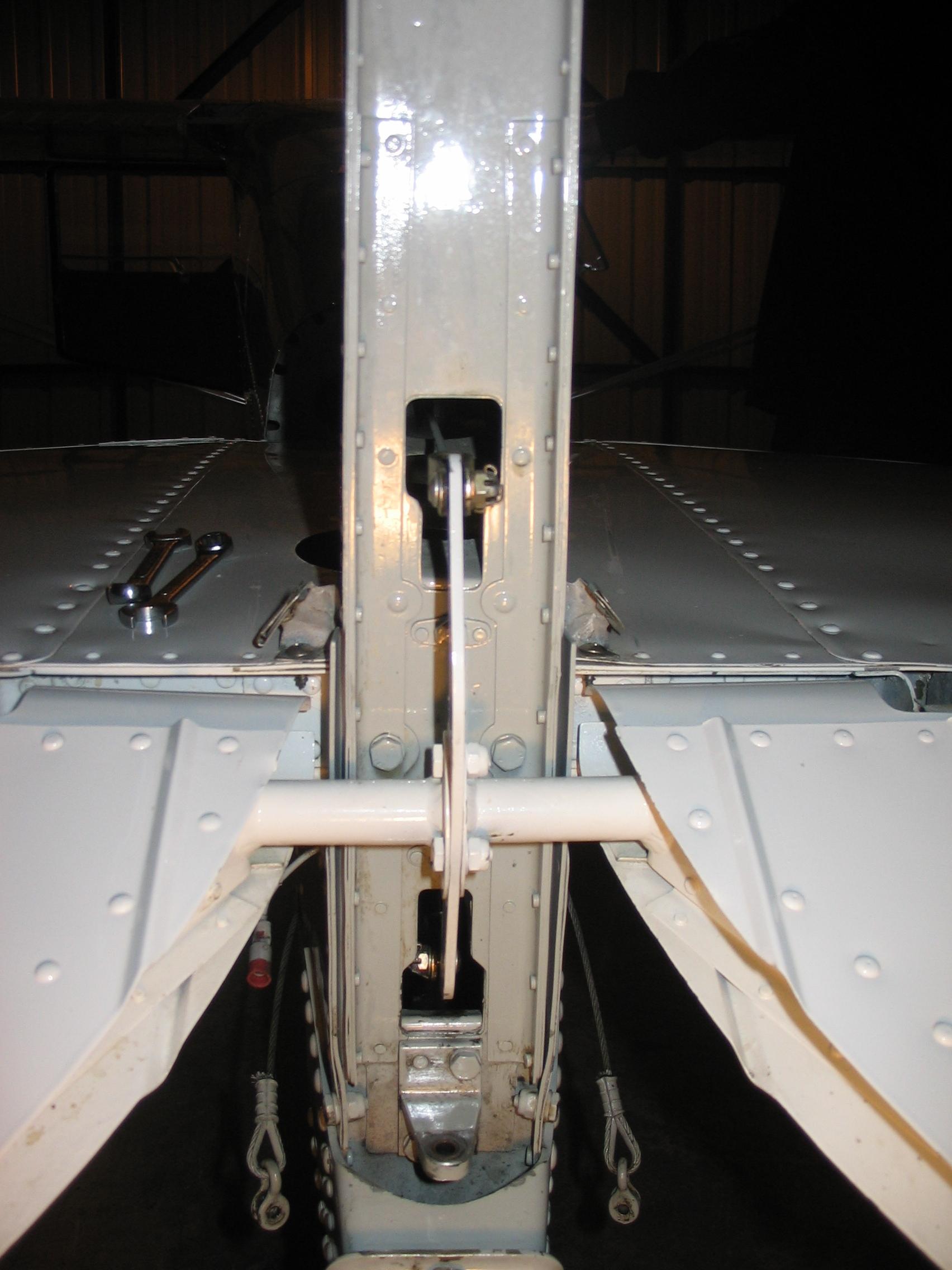

Posted: Thu Jul 27, 2023 7:28 pm
See if you don't already have the mod done. Also, there is a bulkhead reinforcement that you can see from behind the tail thru that squarish hole for the elevator control cable...

by edidin
Great diagram and pics - thanks!
