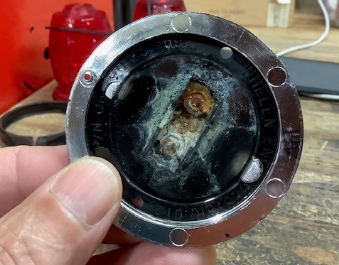

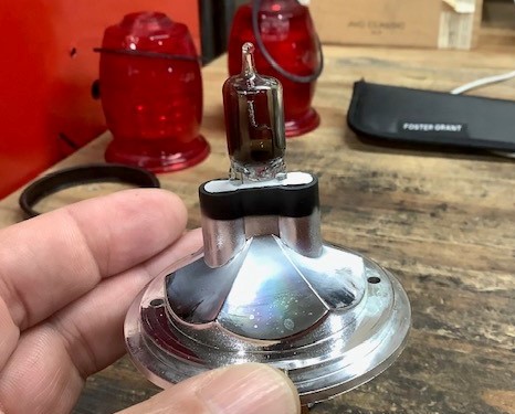

Well, I think I found what might be the problem. I went flying and turned on the electrical systems in sequence. Everything was stable until I got to the Whelen flashers when the voltage started to drop off and the ammeter started jumping around from - 10 to + 10 amps. Turned the flashers off and the voltage and amps stabilized. I landed, pulled the lamps, and found this on the belly light.
- Whelen Lamp.jpg (78.21 KiB) Viewed 4709 times
- Whelen Lamp 2.jpg (89.89 KiB) Viewed 4709 times

Re: Generator/Voltage Regulator Issues?
Yup! That's a sure sign of an overload somewhere.
Thanks for the outstanding info John (as always)! I think, as you saw, I might have uncovered the issue ie corrosion in the lower flasher. I cleaned the pin connectors on the base with DeoxIT and a tiny brush and will get a new bulb installed. I think that must be it because everything else seems to be operating properly. However, if that doesn’t solve the problem I’ll dig in as you advised.
By the way, the top flasher is fine. I think the oil along the belly of the airplane gets into to light housing. Maybe some water? Looks like whatever it was (oil, water or both) caused massive corrosion and the load issues.
Most likely water. Oil doesn't promote corrosion.
