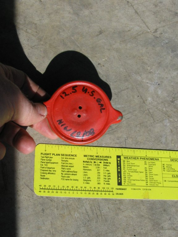

OK, so the 1946 140's did not come with a Left-Both-Right selector option. They only came with a L-R-Off. So, your bird if it has the L-B-R-Off selector it ought to have the vent inter-connect between the tanks and hopefully a 337 or some such logbook notation for the modifcation. If not, then something is very incorrect.
I strongly suggest you read the Neal Wright articles to get you educated. The best one is this I think...
viewtopic.php?f=10&t=105
The gas caps should look something along the lines of this...

The caps do look like that except they are solid (the two holes are not present).
This is getting more interesting....
If the caps are not vented, and it's not a 140A system, there has to be some sort of venting somewhere to allow the fuel to drain out of the tanks. There ought to be an interconnect between the tanks across the top of the headliner somewhere. Please do keep us informed as we don't want you to have any fuel starvation issues. Pictures are worth a thousand words.
