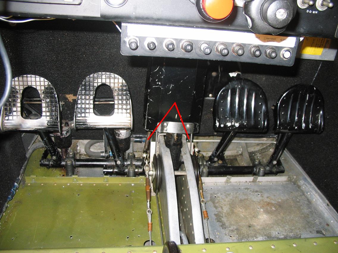

Another thought - depending on the year, you may have the cast or stamped metal pedals. If getting in that deep and you have the early cast ones, I'd change both sides to stamped metal, which was used henceforth on all tailwheel Cessnas. Much easier to get inadvertent braking with the cast ones and since you are planning to instruct...
Heels on the floor is on the checklist of course before landing.
Re: Adding toe brakes to the right side of a 120
Posted: Tue Oct 31, 2023 7:35 pm
Interesting! I have cast on the pilot's side and stamped on the co-pilot's side. Never really noticed a problem. In fact, I'm terrible from the co-pilot's side regardless of the pedals!
(~500 hours left seat, 1 hour right seat...)
Posted: Tue Oct 31, 2023 8:28 pm
I've got cast on the left and stamped on the right, 1460hr left, 0 hours right..... :roll:
Pre-restoration...
