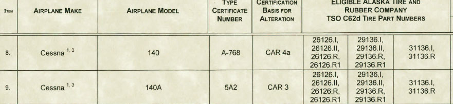

by 5115
While not exactly what you are looking for, but I thought I would put that picture I had on file. Could help other people as well. Good luck!

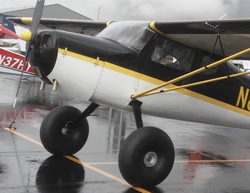

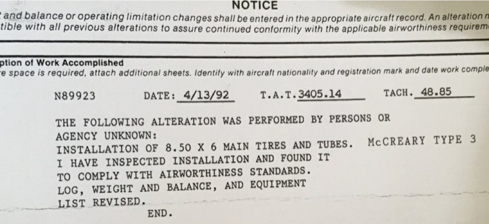

Here’s what I got.
The attachment C7B767A5-A016-4048-A04E-FB0D20B18222.jpeg is no longer available
If money is no concern I would look at the 26” Bushwheel airstreaks they are not that much bigger than 8.50x6 tires. I used those 8.50 tires for years off beaches and gravel bars and yeah if things get bad you can air them down but also risk tire slippage and shearing a valve stem. I just completely restored this plane and have a bit invested so after getting stuck bigger than sh$t on a beach last month I bit the bullet and got the 29” bushwheel and never looked back. Only lost 6-7 mph a tiny bit longer TO roll, but at 8 psi I can smoothly roll over 6” rocks and float over ankle deep sand. Just something to think about as we all use our planes differently. Bushwheel are STC’d for our planes as well. Less of a headache

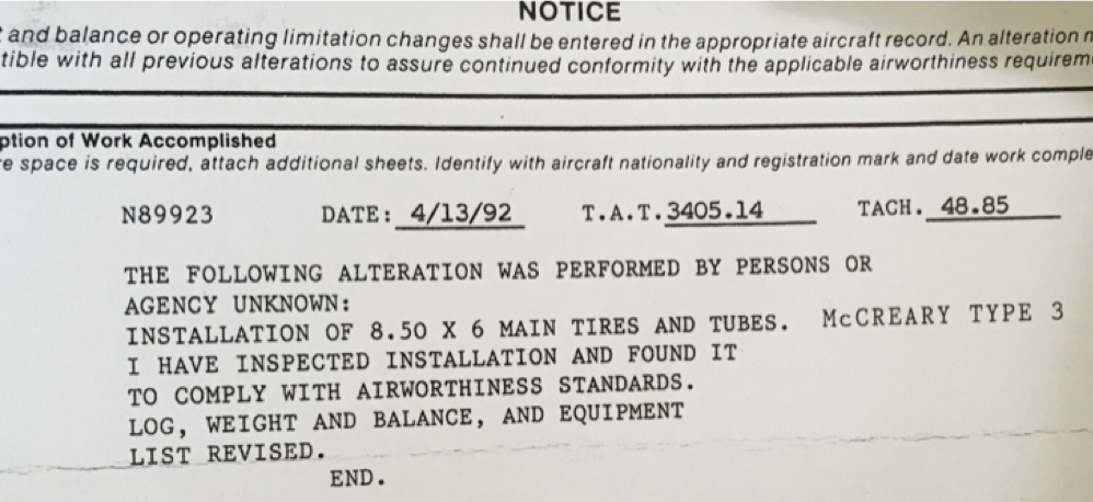

The other attachment.
Re: 8.50 tire install 337
Posted: Sat Aug 25, 2018 1:20 pm
by 5115
woow very neat. looks great with the big ones.
i see that there is single caliper for the brakes. if i remember some of those big tires required double ones.
would that be in relation with the GW for double to be required?
Posted: Sat Aug 25, 2018 2:52 pm
by 5422
The tires require “heavy duty brakes” the FAA definition in one of their mx publications was the ability to hold the brakes at full power static runup and keep tires locked. Those single puck brakes are more than enough. 1/8 inch spacers to move out brake disk were required though to keep brake assembly from rubbing on tire at low pressures. Those tires provide quite a bit of shock absorption. When I had the gear straightened and inspected I had them bend the gear an hair more in so at gross weight the tires would not splay out. There was more than enough edge distance around the original axle bolt holes to enlarge them so a 180/185 steel axle could be used.
