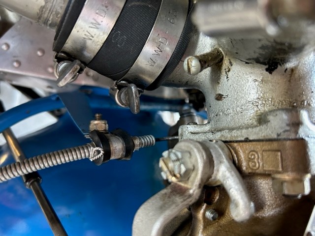

1. After maintining my plane for over 15 years, I had never noticed a nipple on the passenger side of the intake manifold that's plugged with a screw. Very small; approx 1/4" OD. See photo. I don't want to take the screw out so I don't know ID or whether its a passage into the manifold throat. It appears to be cast into the manifold, so I don't think a previous owner added it. I don't see it in the engine diagram. Anyone have an idea what it's for?

I can tell you that my intake spider has ports on both sides, one used on the pilot's side for the primer. The passenger side port is plugged but it is a bigger plug than a 1/4" OD. Maybe someone used your plugged port for a manifold pressure gauge at one point?

Here's mine, o-200 engine. Are you missing a piece? See inner cylinder baffle article Neal WrightBetween the cylinders the inner baffle has quite a gap - 3 finger's worth - between it and the case.
viewtopic.php?f=10&t=1434
Here's my #2 exhaust before sending the cylinders in to Randy to work his magic years ago. Valve probably wasn't seating all the way or warped or some such thing that would impede valve cooling. I had that hue on the exhaust areas and not the intake areas. That copper line on top is for a manifold pressure gauge, installed moons ago by previous owner.Some of the cylinder fins near the exhaust valve on #4, and lower down near the barrel on #2 have a pink hue that I don't remember. Is this a sign of spot overheating?
