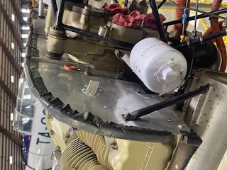

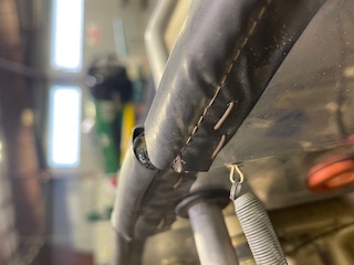

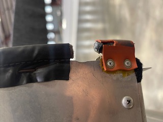

My aircraft has covered felt for engine baffling which is attached with staples. At some point a piece was replaced with new material and pop rivets. Id like to go back to original with that small piece. Anyone have an idea on sourcing the material and the staples? Thanks.
