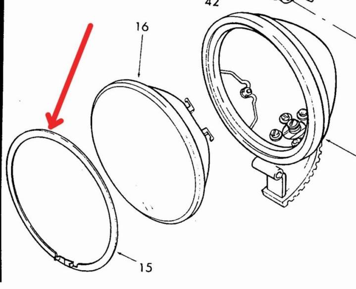

There is a retainer ring that holds the 'bulb' in the housing.

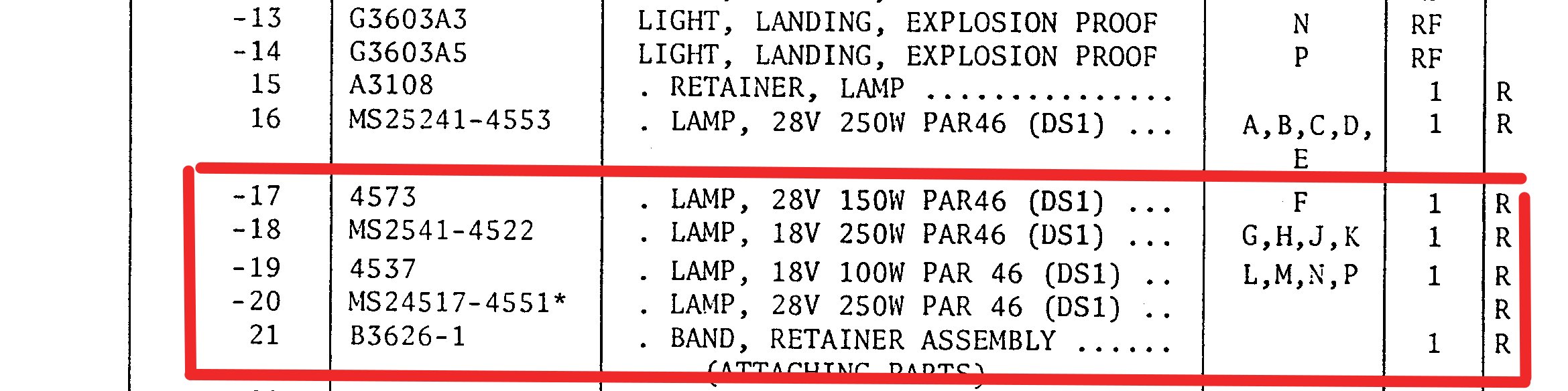

i did the same. Fit just fine. Not sure what a PAR64 is as far as aircraft lighting. I used to burn a 4522 bulb which is a PAR46. A PAR46 diameter is nominally 5.75", a PAR36 diameter is nominally 4.5". You should have a model G-3602 or D-3040A drop down light.
See below from Grimes overhaul manual

Thanks. I must have an odd variant. The light bulb is attached in the center of a ring fixture with three spokes. I measured the interior diameter of the enclosure and it is 6.25 inches. So it’s bigger than a PAR 46. I may have to go back through the logs and see if I can find the part number.
