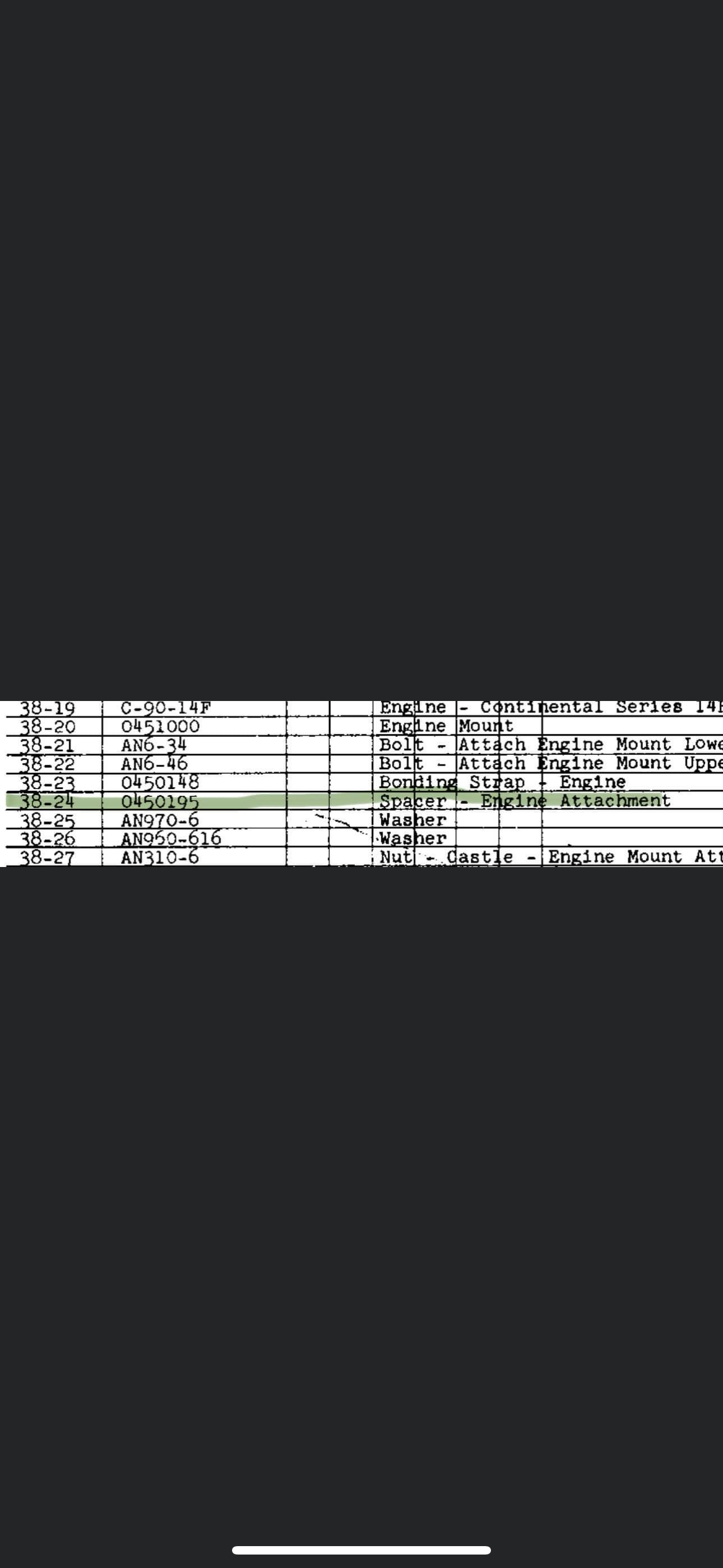

Was looking through the parts diagram and noticed this spacer show #24 (PN:0450195) I have never seen this spacer in any other airplane that uses the conical type engine mount rubbers 85 or 65. I do not have them installed on my aircraft. Anyone know why they are there or have seen them. (I’m trying to chase down a vibration that occurs when I transition between 15-2000 rpm and thinking this could possibly help)
(This was happening before I rebuilt my engine now it’s doing the same thing I’ve tried a different prop and same thing)
Any help is appreciated

Search the forum for that part number. There's been a lot of discussion over the years. (Not a lot of resolution, though...)

My C120 had the metal spacers and I put them back when I change the conical rubbers in May. A C140 also had them. The Cub whose mounts were changed last week did not have the spacers for what it's worth. I believe, though as John notes there are many opinions, that Cessna specified and used the spacers, but Continental/Piper did not.

Oh, I'll bet you dollars to donuts they won't help with your vibration.
Look for something rigidly mounted to the engine that's touching something rigidly attached to the fuselage, like a tail pipe touching the cowl.
