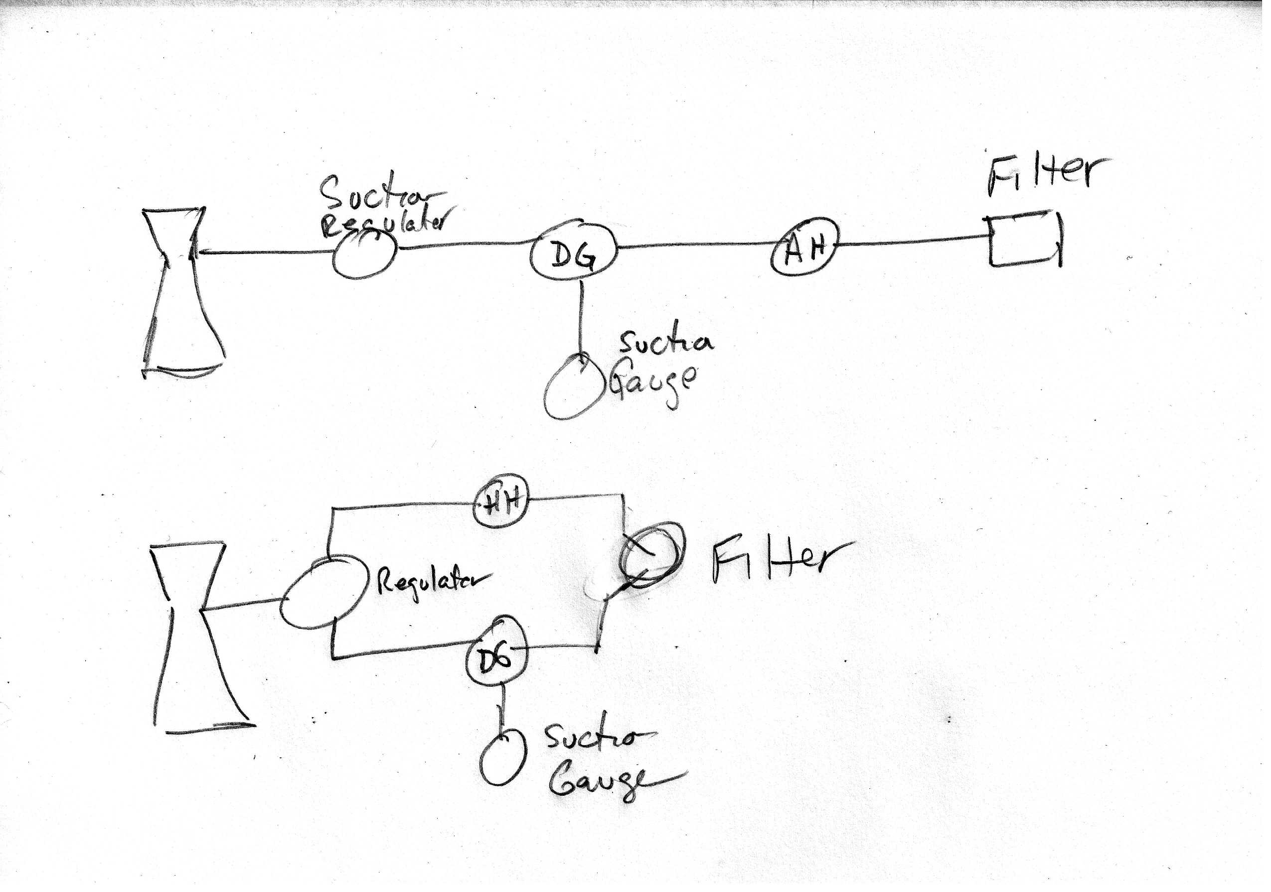

Guys:
I'm working on a plane with a 9" venturi powering a DG and Artificial Horizon. They're plumbed as in the top diagram. Suction gauge shows 6" +/-. The DG precesses badly and 2 different AH's are "inop". I'm thinking the lower diagram would be better. Any expert opinions?

Suction instruments are normally plumbed in parallel with each instrument having its own unobstructed inlet line. Some have a gang filter some are individually filtered.
Your alternate diagram is correct.
You may not have enough suction as a 9 inch venturi for two large gyros is marginal. I doubt that you will even need the regulator. Try it and see.

I was able to run a DG and AH off of a super venturi in my old plane (Bellanca Cruisair) since you couldn't run a vacuum pump off of a Franklin engine (not enough "holes" in the accessory case). The instruments were hooked up in parallel with no regulator. However, since I did fly the plane IFR, I had the venturi ice up twice (I am a slow learner!) so I moved it to a position in back of the exhaust. This pretty much eliminated the icing problem, but it actually reduced the amount of suction I could pull. While it was enough to drive the instruments (barely) I finally just removed the whole vacuum system and installed electric gauges.

So, the second diagram, minus the regulator?

Just got some more info from the previous owner. The system worked in it's current (series) configuration until he had a "hard landing" at which point the horizon quit. I (actually he) acquired a used (unknown) horizon which I installed and it doesn't seem to work, either. At this point I'm tempted to have the original overhauled, I just don't want to do that then find it still doesn't work...6641 wrote: ↑Fri Aug 17, 2018 12:45 pm Suction instruments are normally plumbed in parallel with each instrument having its own unobstructed inlet line. Some have a gang filter some are individually filtered.
To add insult to injury, the panel space is very limited, and I have actually tried to install 3 different used unknown gyros. The third one fit, but...
